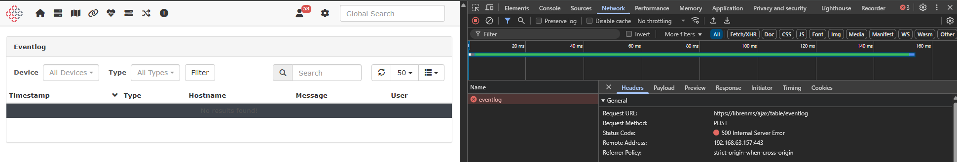

Eventlog blank
I have no eventlogs populating in the Eventlog section. I do have recent events under the specific devices, as well as information in the eventlog table of the database.
The only error logged is the following:
Carbon\Carbon::setTimezone(): Argument #1 ($timeZone) must be of type DateTimeZone|string|int, null given, called in /opt/librenms/app/Http/Controllers/Table/EventlogController.php on line 122 {“userId”:1,“exception”:"[object] (TypeError(code: 0):
And this 500 Server Error
LibreNMS 25.4.0-97-gda833d6cc (2025-05-05T22:09:53-04:00)
DB Schema 2025_05_03_152418_remove_invalid_sensor_classes (338)
PHP 8.3.6
Python 3.12.3
Database MariaDB 10.11.11-MariaDB-0ubuntu0.24.04.2
SNMP 5.9.4.pre2
[OK] Composer Version: 2.8.8
[FAIL] Poller is not running. No poller has run within the last 300 seconds.
[FAIL] No active python wrapper pollers found

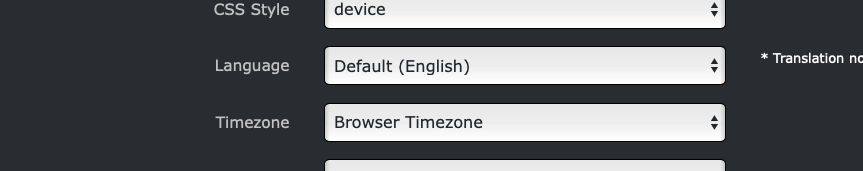

Odd. That’s suggesting you don’t have a timezone set.
In your ‘My Settings’ page, what TZ do you have selected?
Thanks for the response! I had “Browser Timezone” configured. I changed it to my local timezone and that corrected the issue. The eventlog populated immediately. I appreciate your help.
So there is a bug with browser time?
Looks that way, we could set a default when we try and retrieve the TZ from the session?
