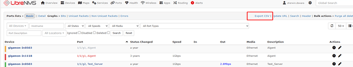

https://localhost/csv.php/report=ports/ to https://localhost/csv.php?report=ports/ and it works. but i need to fix permanently what file should i edit? im using a docker container - where can I edit these to solve this problem

even i installed this one in my local pc. its says 404 not found still but when i change the path [csv.php/report=ports/] should be this one [csv.php?report=ports/] its correct. why?

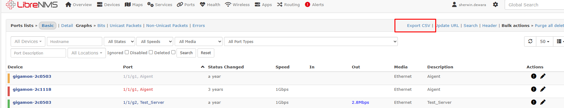

Have you tried this link?

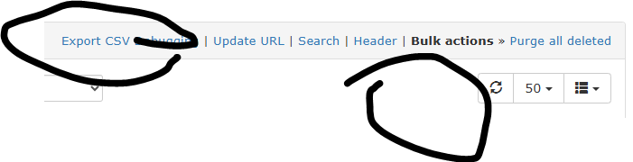

Hi Murrant i dont have that kind of export to csv

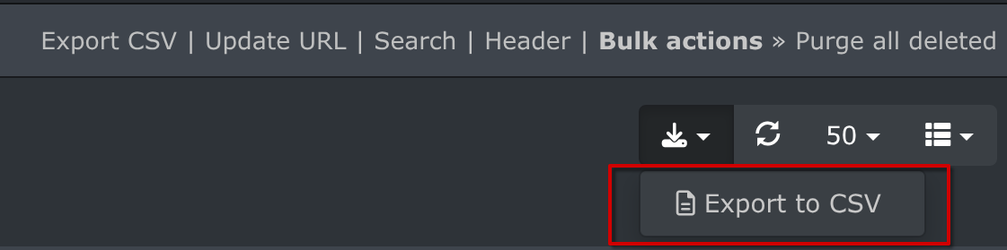

Hello, Your LibreNMS is out of date.
How to update it without deleting the data?
