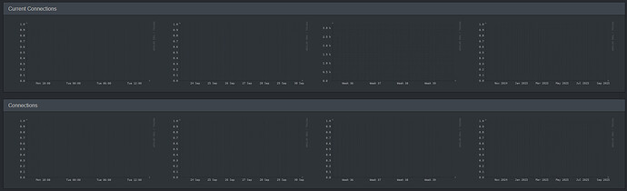

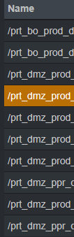

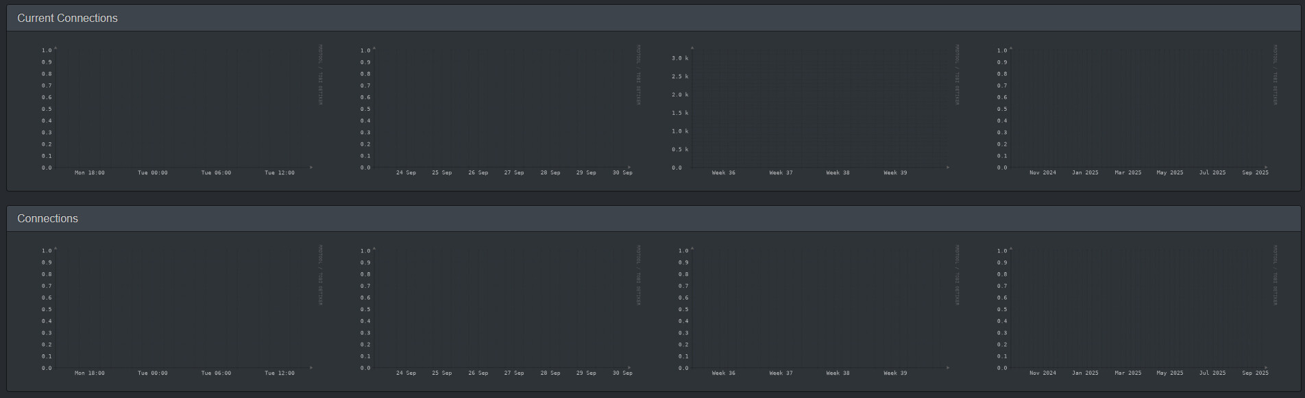

Hello, I am having a problem with graphs on my F5s, particularly in the loadbalancers tab > LTM Virtual Servers () (tab=loadbalancer/type=ltm_vs/). I tried snmpv2 and v3, but there are no graphs… However, with snmpwalk v3 or v2, we can clearly see “STRING: ”/prt_dmz_noprod_…" so my F5 is displaying the complete list of Virtual Servers, but there are no graphs… Do you have any solutions to offer me? About LibreNMS : 25.3.0-78-g2edcaaed9 - Tue Apr 01 2025 08:11:59 GMT+0200
RRDtool 1.7.2
Best regards,
Paalkia.
