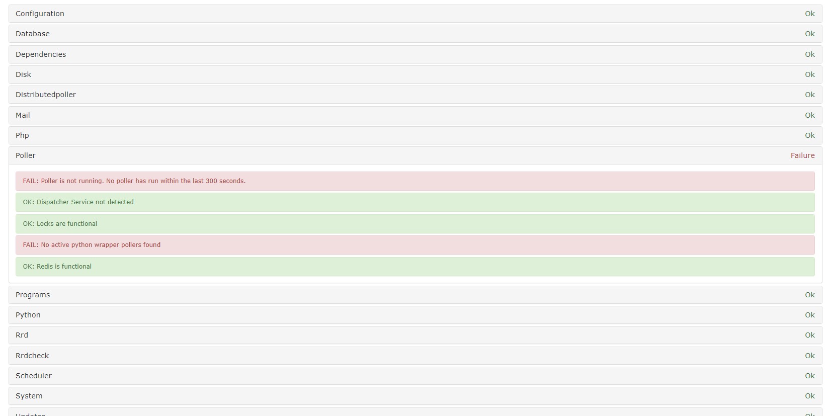

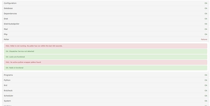

FAIL: Poller is not running. No poller has run within the last 300 seconds
i am running librenms version [24.8.0-62-g77fa7573c ] but still facing poller issue.
Have you restarted the service?
i have not changed anything else. validate.php returns same items failing as mentioned above. Any suggestions?
Update and try again.
You can also run (jq needs installing) php config_to_json.php |jq|grep db_pass and if you get a response then it should be fine, if not something else is broken
i rebooted the server but still poller not running.
i did a reboot. Validate.php is now all OK. Poller is running again. So seems to be fixed.

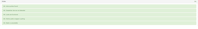

After running
./daily.sh
and waiting for 5 minutes, the issue appears to be fixed.
Thank you :slight_smile:
Resolued.

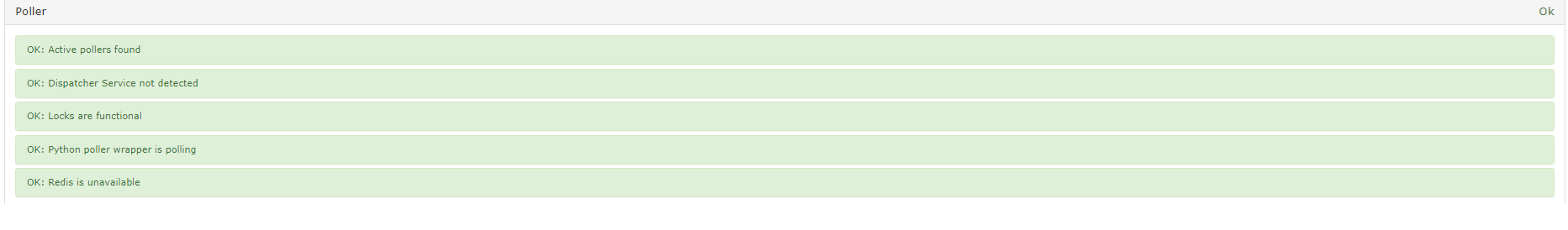

I have the same issue. It happens right after the midnight daily update.
Update your install manually by running ./daily.sh
Tks man, it’s FIX the bug and my day ! :face_with_head_bandage:
