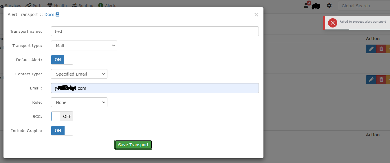

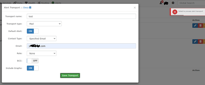

Getting this error whenever I try an edit a transport or even create a new one. I saw something about DNS but that looks fine and I use an FQDN for my email server.

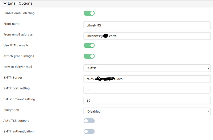

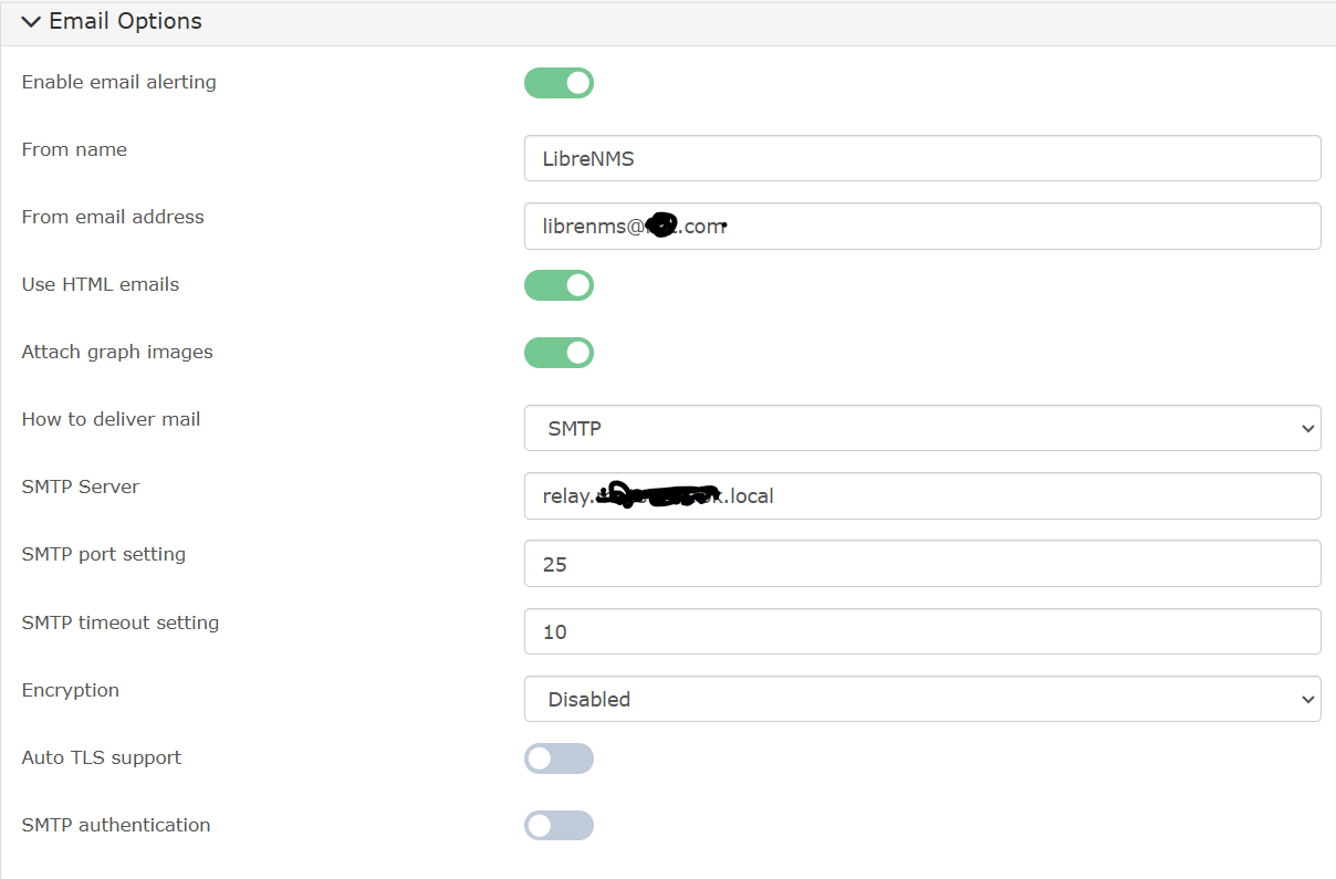

Got a picture of your LibreNMS Email Options in settings? maybe something wrong in here which is failing its reach to the smtp server? Also ensure the ports are not blocked for email.
Nothing to fun in there. Again the test emails work over and over without issues. Thanks!
Set Role to None
Assuming you are referring to the role in “Alert Transport”? If I try to create a new one with “none” I can’t save it due to “Failed to Process Alert Transport” and same issue editing an existing one. If you are referring to some other location please let me know.

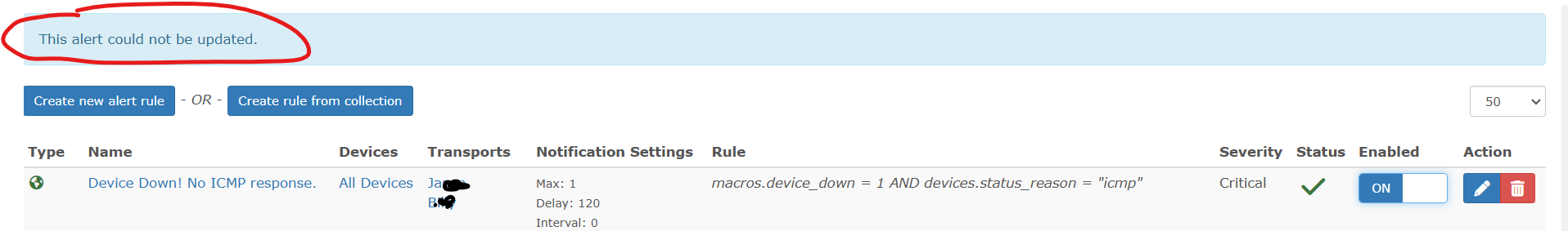

So this morning, I got an email when the device recovered but not when it went down. So I went into my rules and thought maybe I will disable and re-enable it. When I try to disable it it fails and says “This alert could not be updated”.
Seems like my whole alerting system is broken. Can’t seem to edit things/create things, delete things. What is at the heart of that system that could be causing this?

In the email transport, you can’t have Role set when a specific email address is used.

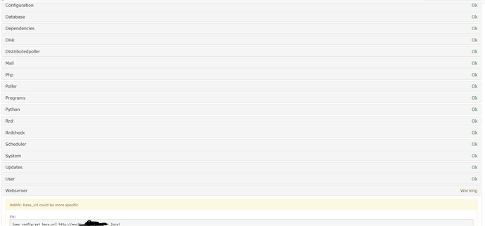

Also run validate from the Webui.

Are you referring to under alert-transports? When I view that it shows the Role as “none”

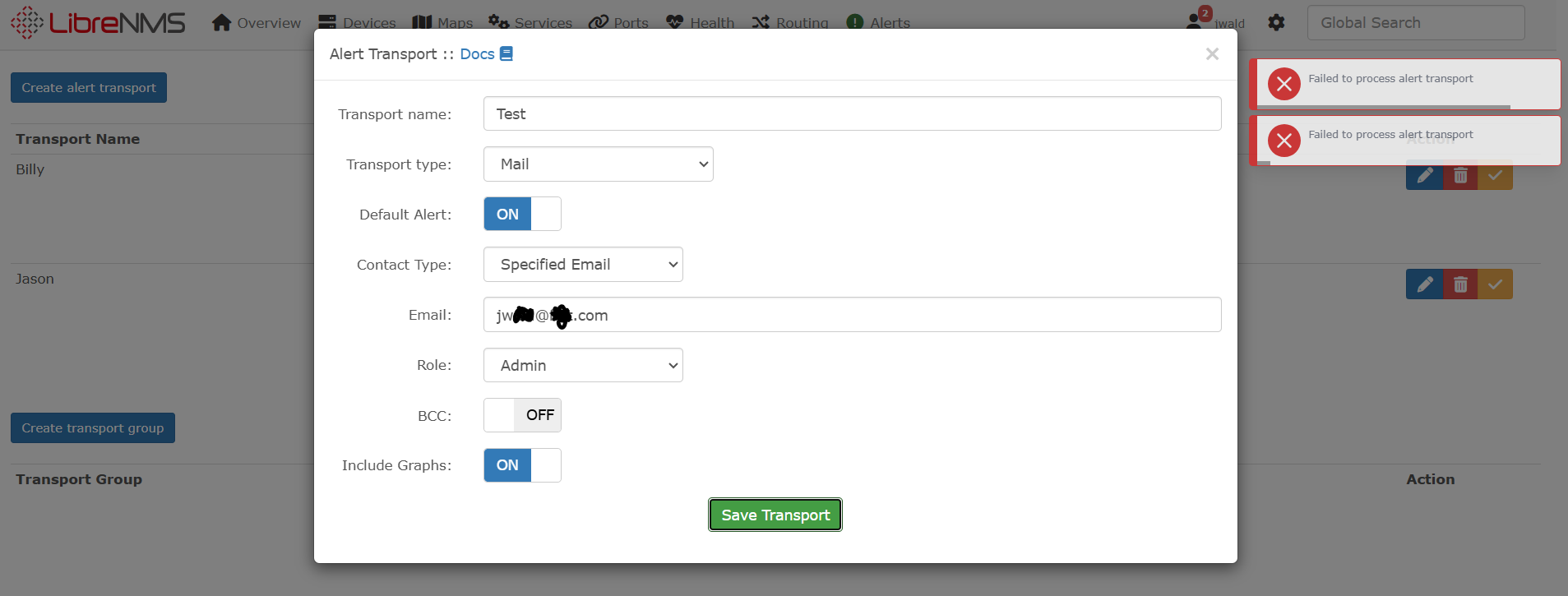

The first screenshot of the thread was just simply trying to create a new one since I cannot edit the old one. So I just did another test creating a new one and same red error message on the side.

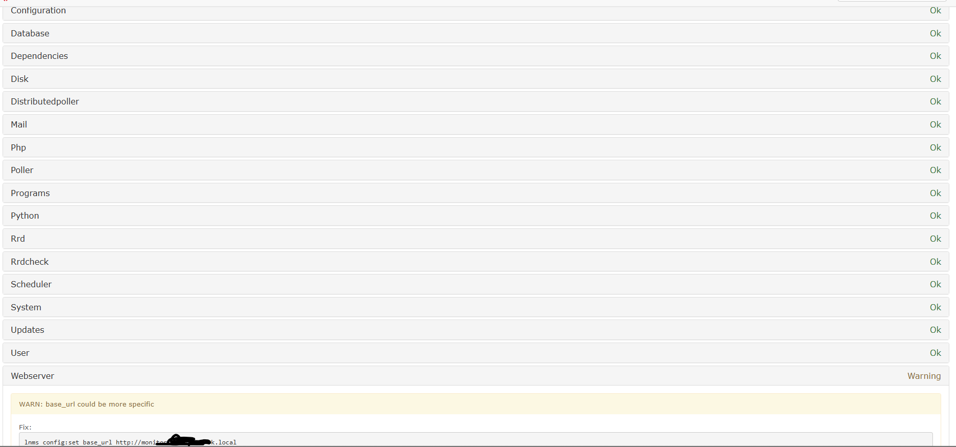

Nothing exciting in the validate unfortunately.
