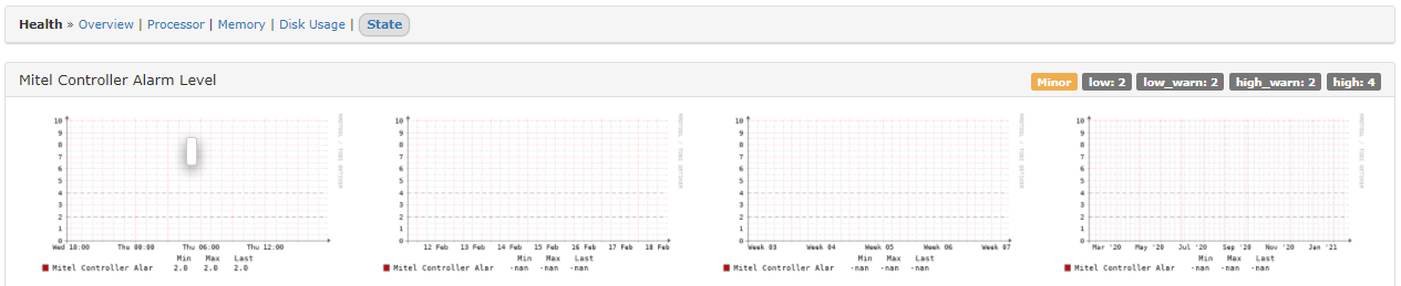

Hi @Kevin_Krumm
I’ve updated the includes/definitions/discovery/msl.yaml with the following fields and can now see a sensor in the Health Data. Generated an alarm and this reflected in the graph.

Is there also a better way of showing this, like a guage, as there are only 4 possible values?
Is there also a way of pulling down the alarm type data as part of the polling?
