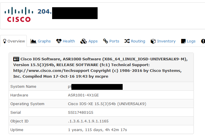

Looking at the dashboard, and inventory it is all using the IP, not the sysname. Could this also be a vendor specific issue? I am just testing with a Fortigate right now.

Just tried with a Cisco router, looks like the sysname option is not working either.
