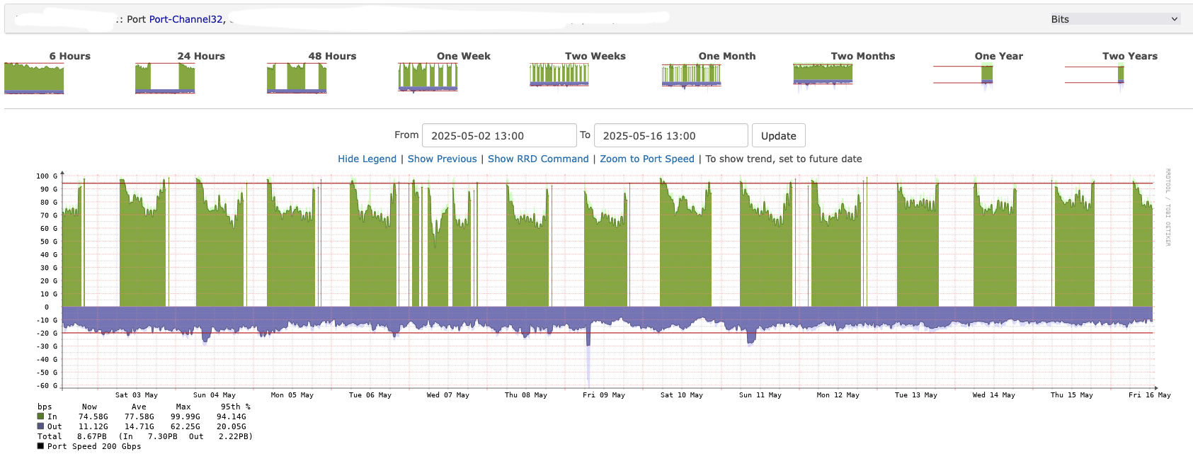

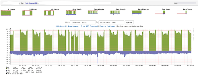

I am seeing missing data in the traffic graphs for all port-channel interfaces. The physical interfaces don’t have this issue—only the port-channels show gaps. These port-channels are 200G or higher.
Has anyone else seen this or know how to fix it? Thank you!
Yes, you exceeded the values allowed by the rrd file. That can be fixed though:

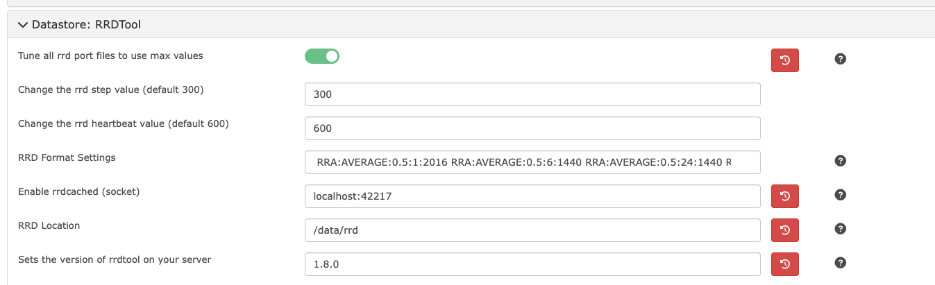

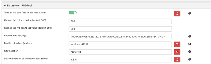

Thanks- I enabled the “Tune all rrd port files to use max values” options but still seeing the traffic gaps. Do I need to adjust any other setting here?
And ran the script in the docs linked above?
That was it, thank you!
Ran the script after to resolve: “./scripts/tune_port.php -h -p ”
