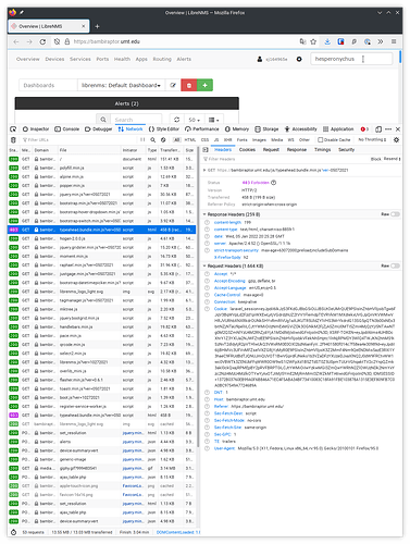

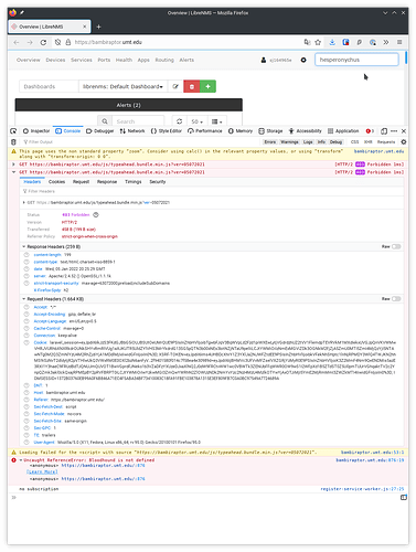

I’m seeing some 403 errors on typeahead.bundle.min.js; not sure if that’s relevant or a red herring, but it’s the only out-of-place thing I’m seeing.

Definitely wouldn’t help that that file is 403ing.
What happens if you try to go straight to that JS file in your browser, does it still 403?
Same issue here, getting 404 errors, going to the link itself seems to indicate the file is not there.
device:1 GET http://librenms.**********.net:8080/ajax/search/device?search=je 404 (Not Found)
It does, and upon navigating to /opt/librenms/html/js and doing an ‘ls -larth’ I found that typeahead.bundle.min.js had permissions of 640 instead of 644.
Changing the permission to 644 fixed the search box.
No idea why that would have changed, I don’t make a habit of chowning or chmodding a working LibreNMS install…
