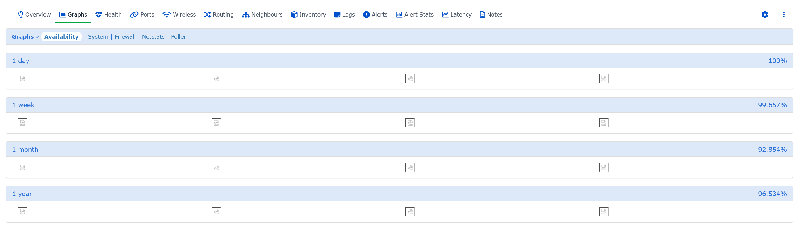

Graph do not open
Cant’ zoom graphs then click nothing happens.

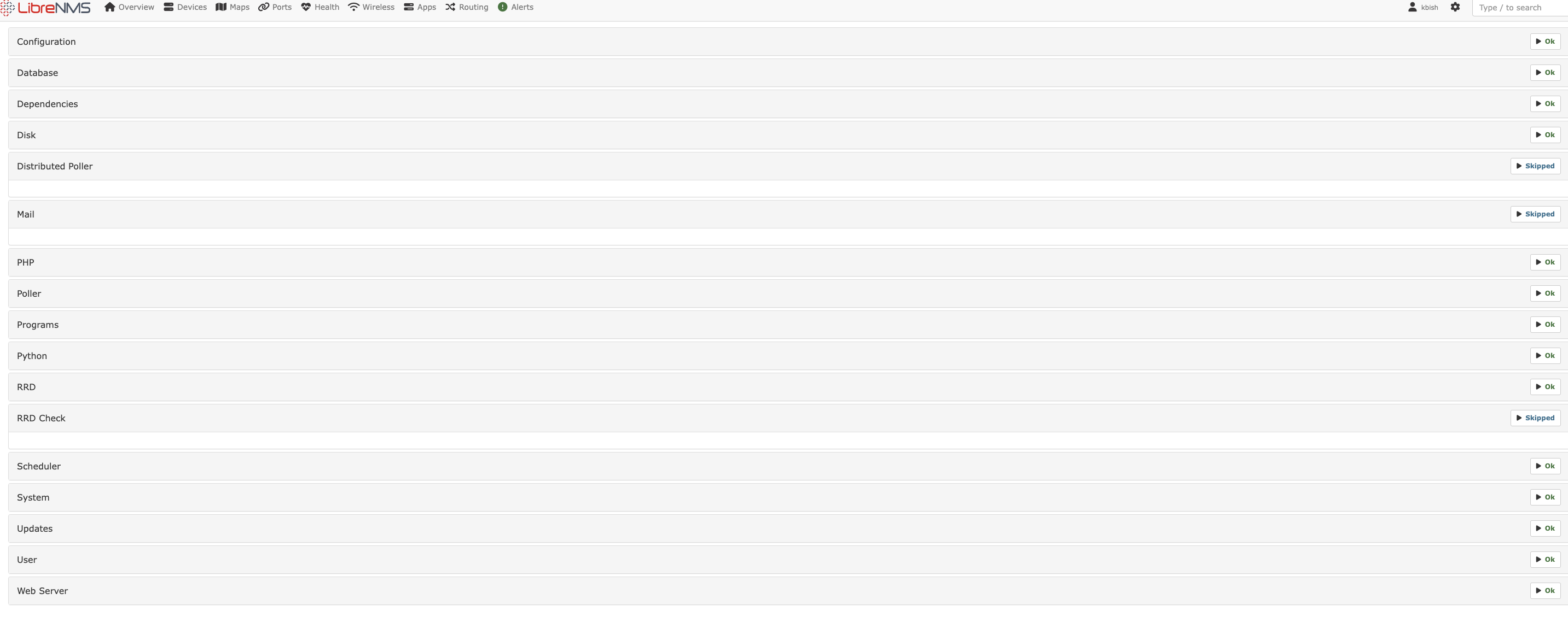

I can’t replicate that. Check validate in the WebUI
Validate in the WebUI also show OK.

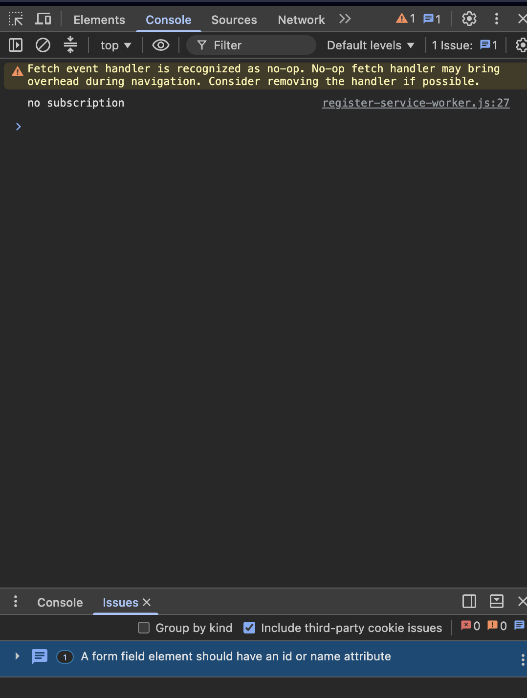

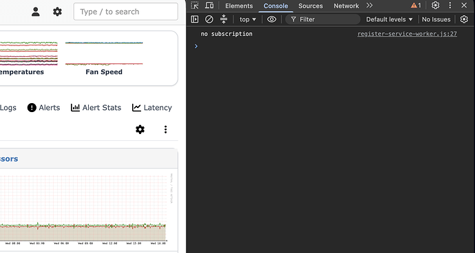

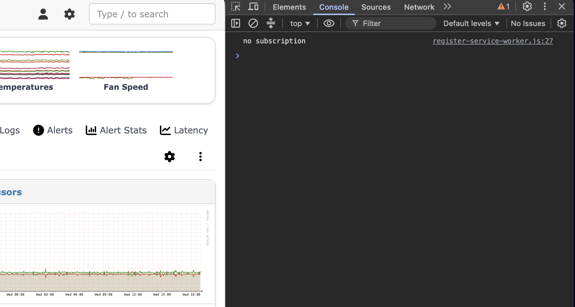

Do you have anything logged in your developers console of the browser?
