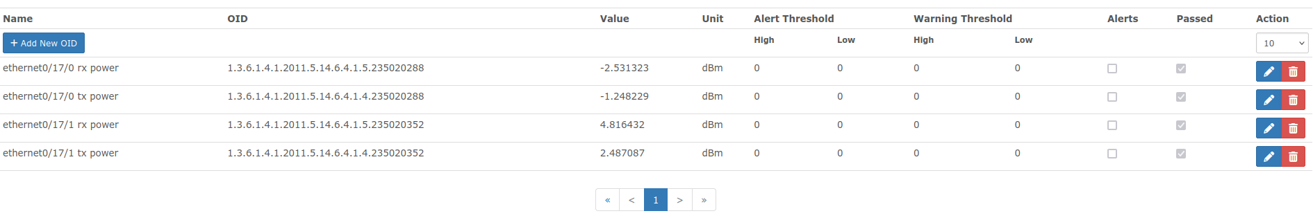

in the settings I see that the value from the snmp is obtained, but the graphs are not available. during the investigation it turned out that the graph has a different name.
Here are the settings:

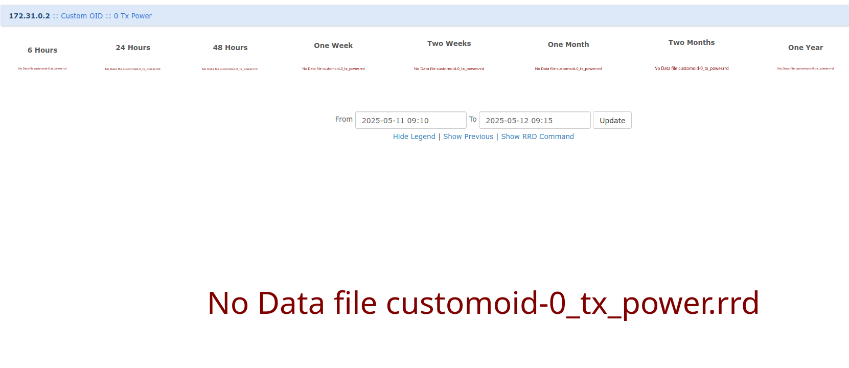

this is what the web is asking for:

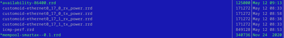

and here is what is in the RRD storage
as you can see - the RRD names are different.
if you change the name in the storage to what the web asks for - the graphs are displayed normally.

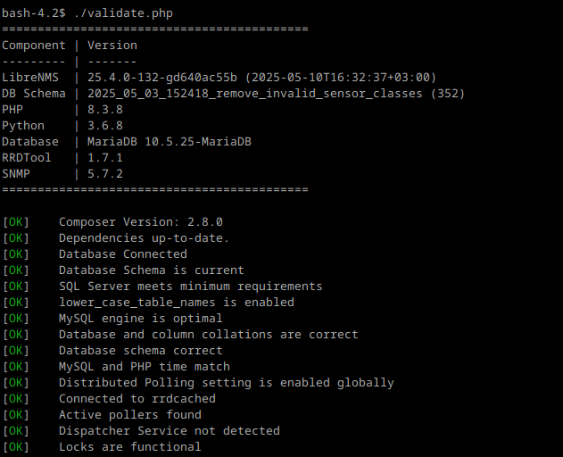

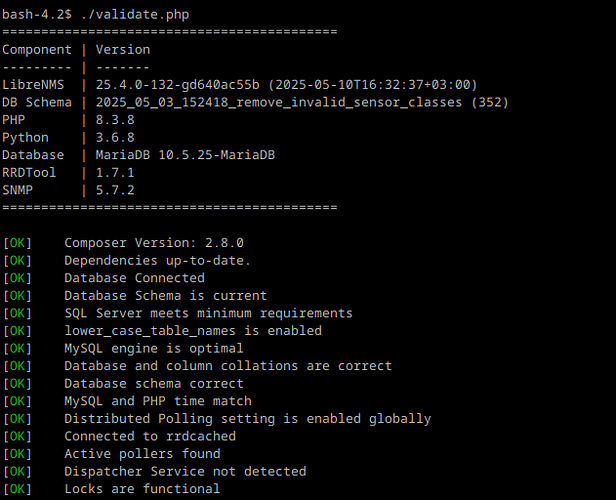

my validate:
upd. renaming solves the problem.
ethernet0/17/0 rx power → ethernet0_17_0 rx power
