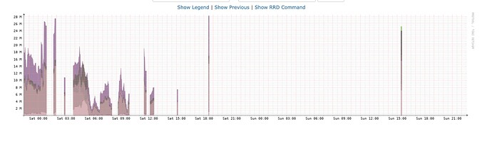

im facing an issue with LibreNMS where the graphs are either completely empty or have stopped updating recently. The polling seems to be working based on the logs, and services are running fine

hmm, I wonder what graph or type of device this is…
Hello
This is traffic data for MikroTik devices. I have two LibreNMS instances: one where the graphs are working correctly, and the other where they are not displaying at all. Below is some information from both systems:

Instance with graphs not drawing:
librenms@librenms:~/rrd/172.16.150.1$ rrdtool fetch sensor-voltage-routeros-0.rrd AVERAGE --start -1h --end now
sensor
1751299200: -nan
1751299500: -nan
1751299800: -nan
1751300100: -nan
1751300400: -nan
1751300700: -nan
1751301000: -nan
1751301300: -nan
1751301600: -nan
1751301900: -nan
1751302200: -nan
1751302500: -nan
1751302800: -nan
How about the poller debug output?
