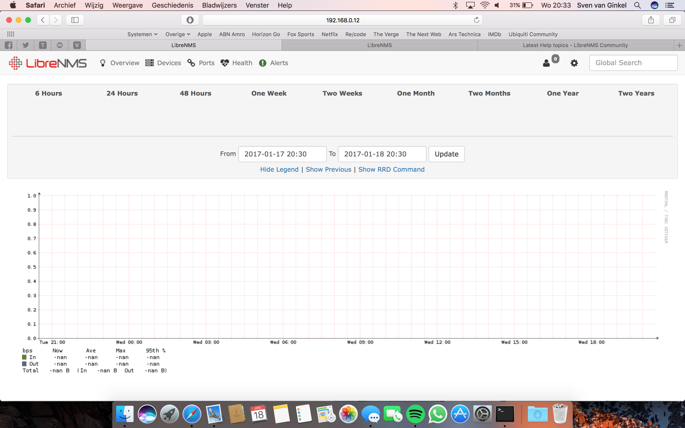

Graphs show -nan
I just installed LibreNMS on a Ubuntu Server. Only none of the graphs will show any data. They all shows nan.
permissions for the RRD folder and poller rights seems to be good as far as I can see.
Output ./poller.php -h all - librenms poller - Pastebin.com
sven@ubuntu:/opt/librenms$ ls -la /opt/librenms/rrd/
total 16
drwxrwxr-x  4 librenms librenms 4096 Jan 18 19:38 .
drwxr-xr-x 19 librenms librenms 4096 Jan 18 20:33 ..
drwxr-xr-x  2 librenms librenms 4096 Jan 18 19:38 192.168.0.1
drwxr-xr-x  2 librenms librenms 4096 Jan 18 19:38 192.168.0.57
Can someone point me in the right direction?
Thanks!
