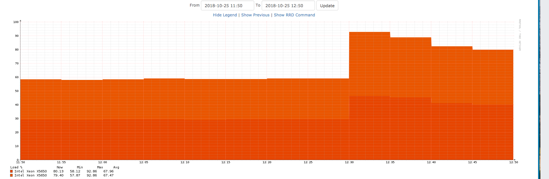

I changed my settings and received an alert. When I looked at the graph, there was not high cpu for 30 min, just within the last 5 minutes only.

It does not seem to be doing so… Please see images showing my alert configuration is for 30 min. This alert came in at 12:45PM but if you look at the CPU graph it does not show 30 min of high CPU.
FYI, the delay only applies to notifications. The WebUI always shows all active alerts.
