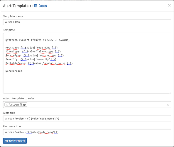

How to display or pass the $alert->faults values
I am trying to utilize the information from snmptrap ‘message’ field to display and pass the values.
But other than Alert Template standard processing method, these values are not getting substituted even for Alert Template’s, Alert title or Recovery.
900×758 20.8 KB
If these values can be display or passed, then how can we send them through API.

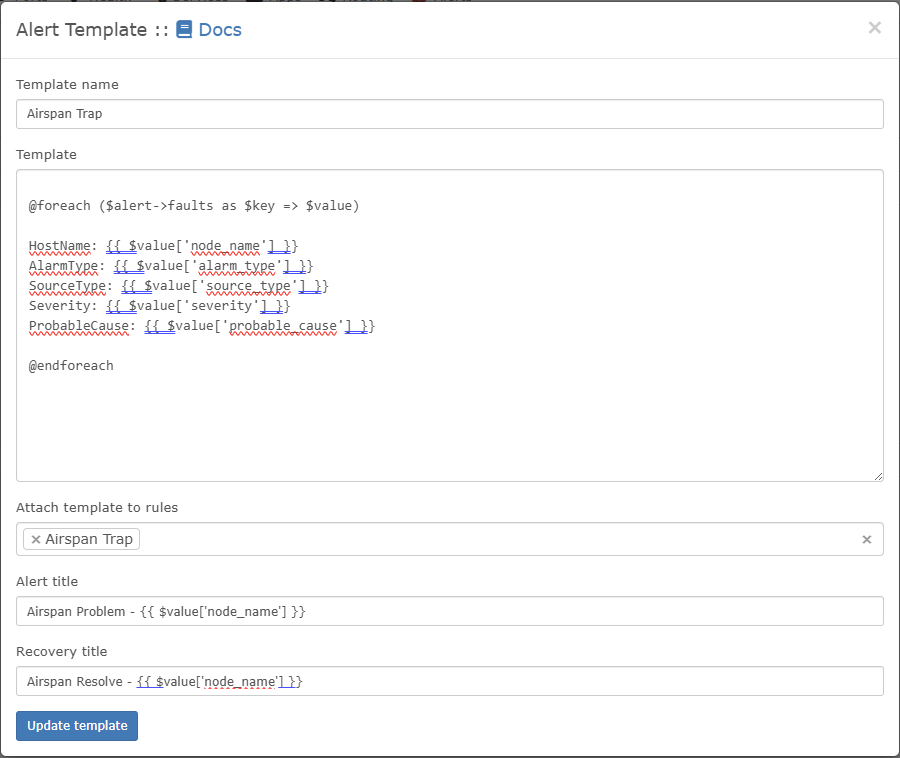

Template code:-
@foreach ($alert->faults as $key => $value)
HostName: {{ $value[‘node_name’] }}
AlarmType: {{ $value[‘alarm_type’] }}
SourceType: {{ $value[‘source_type’] }}
Severity: {{ $value[‘severity’] }}
ProbableCause: {{ $value[‘probable_cause’] }}
@endforeach
