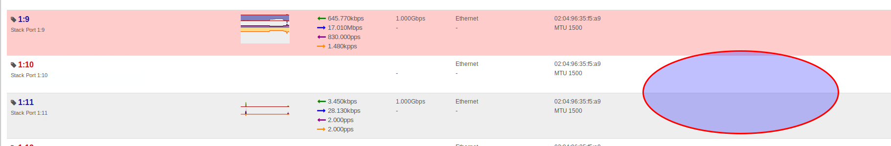

I have two extreme switch devices which are connected on a port, but there is no link between two ports in the webinterface.
How can I (manually) link these two ports?
This is a cisco switch where it does work:
This is the Extreme switch where it does not work:
Links are discovered by XDP(CDP/LLDP/FDP). Enable it on your extreme switches
There is no way I can do this manually?
No you need to enable that on your devices also check out doc.librenms.org for discovery.
