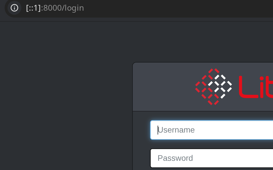

It isn’t considered a bug because other people have been able to use IPv6 literals. This means it is likely a configuration issue specific to your install. Which needs to be individually troubleshot.
I just tested:
Any chance I can ask you to run curl -v https://[::1] -k ? Maybe this is only on https not http ?
May I ask if you have [::1] in APP_URL and/or base_url ?
Just verified to ::1 as well:
