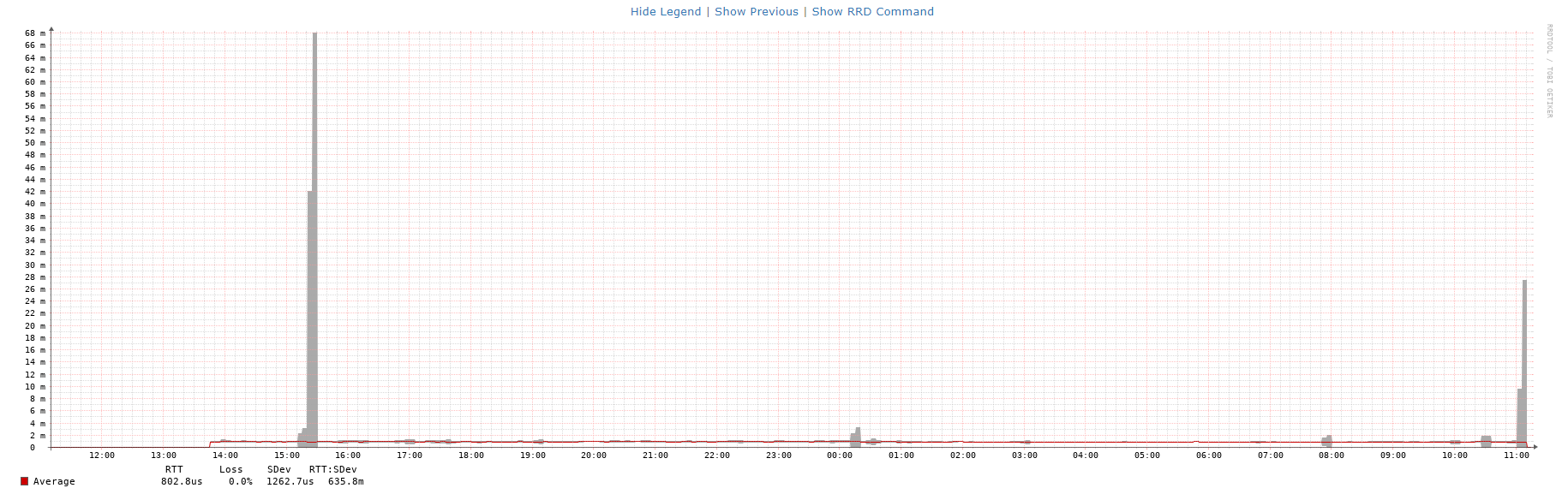

overview -> tools -> smokeping , takes me to smokeping web … this is ok.
but … where are smokeping graphs on my librenms ?
I can see , smokeping are creating rrd graphs at:
[root@smokeping ~]# ls -altr /opt/smokeping/data/network/
total 8764
drwxr-xr-x. 22 apache apache 4096 Oct 1 13:42 ..
drwxr-xr-x. 2 apache apache 79 Oct 1 13:42 .
-rw-r--r--. 1 apache apache 2986808 Oct 1 14:13 172_22_255_10.rrd
-rw-r--r--. 1 apache apache 2986808 Oct 1 14:13 10_80_25_1.rrd
-rw-r--r--. 1 apache apache 2986808 Oct 1 14:13 172_22_255_250.rrd
Ok … any help on this would be great.
