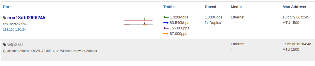

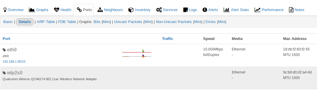

I have a strange problem with the ethernet interface of my laptop (Dell XPS 15 with Linux Mint 18.1) in LibreNMS. When I start my laptop the interface name in LibreNMS is ‘eth0’. LibreNMS does not draw interface graphics for this interface. When I restart the snmd service on my laptop the proper interface name is polled and interface graphics are drawn.
I suppose it has something to do with the net-snmp deamon on my laptop but I am not sure where to look. I can’t find where and when the interface name/alias is set.
The output of these commands don’t show any errors. ‘enx18dbf260f245’ is listed as interface name and interface description. But this is after I have restarted the snmp daemon.

Yesterday I updated to 1.34 and now my wireless interface lists two times. The first entry carries the IP address of my LAN port instead of the wireless port:
This is before I restart the snmp daemon on my laptop.

When I restart the snmp daemon and set Port Association Mode back to ‘ifIndex’ again the wireless interface shows up two times as seen in the first picture. The interface ‘enx18dbf260f245’ does not show up at all.

[EDIT]. Rebooted the laptop. But now the interfaces appear as follows in LibreNMS:
I am a bit puzzled here. The first interface shows the name of my wireless interface, with the MAC address of the wireless interface and the graphs of the Ethernet interface. Then second interface shows the name of my wireless interface, with the MAC address of the wireless interface but with the IP address of my LAN interface.

So this is what happens. The event log lines from 10:45:03 - 10:50:11 appear when I start my laptop. When I restart the snmp daemon the eventlog lines 11:20:11 - 11:20:14 appear. Clearly when the snmp daemon is started the wrong interface name is advertised in snmp.
