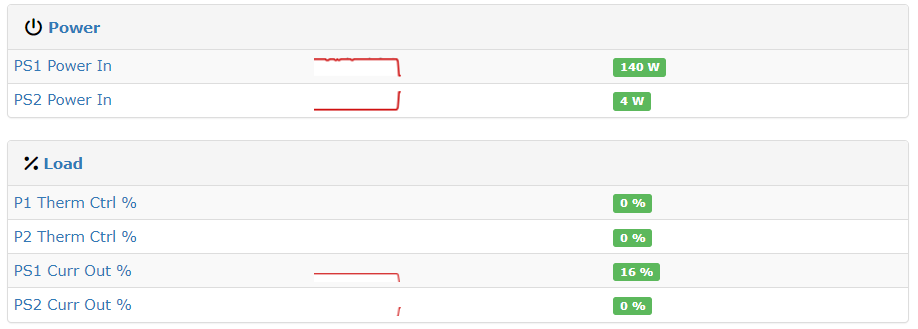

We have a number of Intel servers running Windows Server that I monitor using both the Windows built in SNMP server and the motherboards BMC. (via IPMI support in LibreNMS)
IPMI works well and provides sensor data like temperature sensors, fan speeds, voltages, power consumption and percentage of maximum power supply output:
However one set of sensors that is not polled (and/or exposed) is power supply status.
In other words if one power supply fails or loses power there are no sensors in LibreNMS to show this or set up alerts for.
Looking for a Power in figure of zero for an alert is not workable as most of the servers seem to operate the PSU’s in hot standby mode rather than load balancing. So one power supply supplies the full load for about a day, with the other showing zero watts then they swap and so on.
