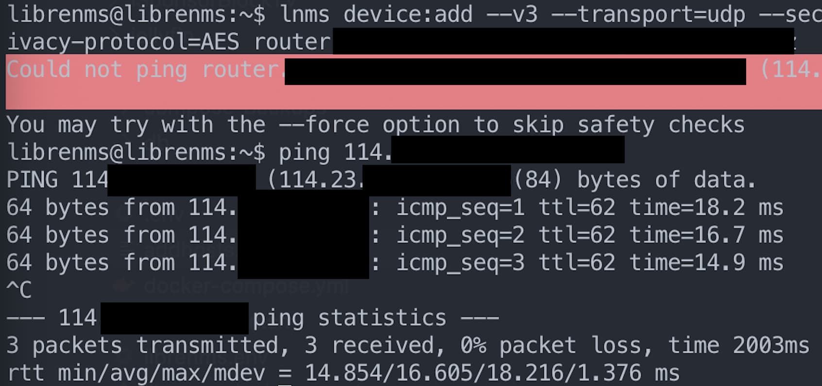

I rebuilt a fresh Ubuntu 24.04 VM to run LibreNMS on (no docker), and installed everything according to the guide. It went relatively smoothly. I then imported all my devices again using addhost.php. Most went fine, and are showing online until I hit this issue:

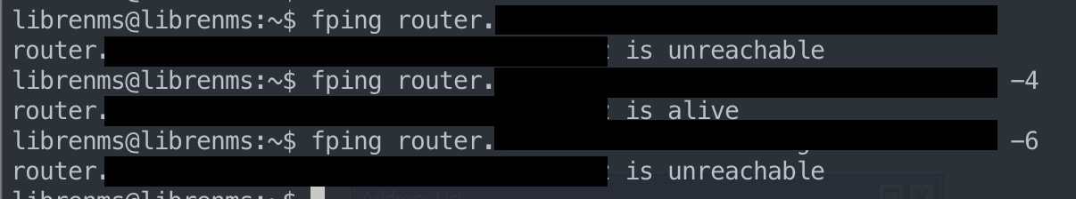

I traced this to fping defaulting to IPv6
If I run fping <router>, i get unreachable
If I run fping <router> -4, It is reachable.
So I guess there are questions at this stage:
  1. Is it possible to make fping use ipv4 or ipv6 (ideally based on the transport type passed in to lnms add - i.e. if its udp6 or tcp6 use fping -6, if not use fping -4?
