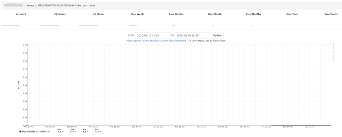

Hi! I’am seeing the same polling issue of the RPM percent loss value.
The Librenms graphs always shows ‘0.0’ of loss when the correct value it’s another.
show snmp mib walk jnxRpmResSumPercentLost ascii
jnxRpmResSumPercentLost.“MPLS-MONITOR”.“SCL01TMC01-B”.4 = 102907
My rpm config it’s the following:
> test SCL01TMC01-B {
probe-type icmp-ping;
target xxx;
source-address xxx;
data-size 56;
dscp-code-points be;
probe-count 15;
probe-interval 1;
test-interval 300;
Any idea about how to fix this?
