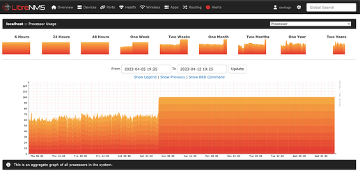

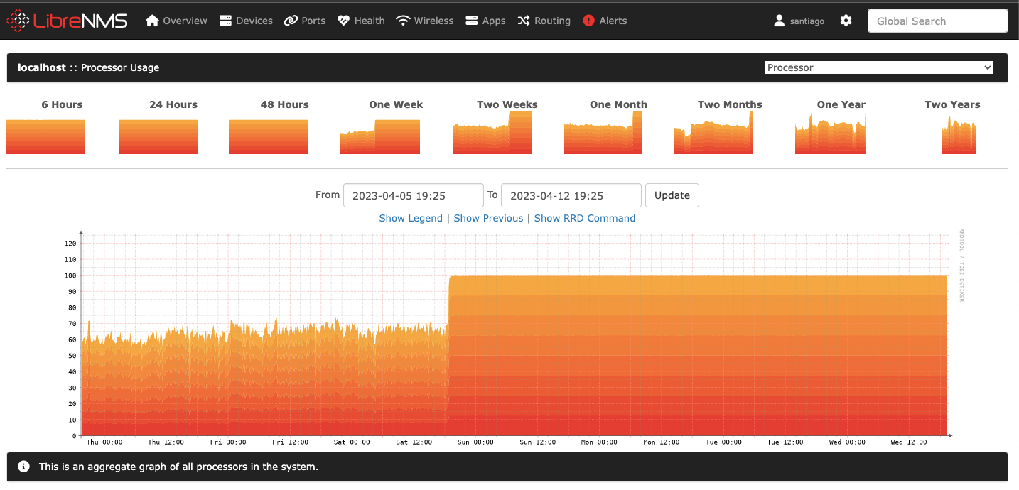

I also am running a fully updated Centos 7 VM, with about 1100 devices. It always ran pretty hot but was able to poll all devices without falling behind.
As of the 23.4.0 release, it no longer is able to poll all of my devices. I spent the greater part of the weekend troubleshooting and have not found a solution.
I disabled polling on all devices, then did a reboot. Over the next 6 hours or so I slowly enabled polling on devices in groups of 50. After each group was added I waited until all devices showed up as being polled before continuing. By the time I reached 825 devices (just 75% of my full list) the server CPU was pegged at 100%. Based on this alone 23.4.0 requires about 25% more resources than the previous version.
