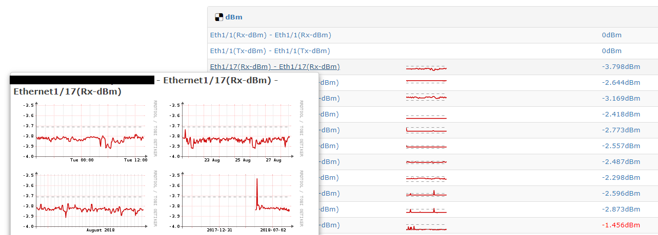

How does Libre get the different threshold values for transceivers , I noticed some discrepancies.
ie on a Nexus5548
The graph has a threshold of -3.7 but “show int eth1/17 transceiver details” has no such threshold.
another example:
Dbm Ethernet1/22(Rx-dBm) - Ethernet1/22(Rx-dBm) under threshold: -1.456 (< -1.4532 )
