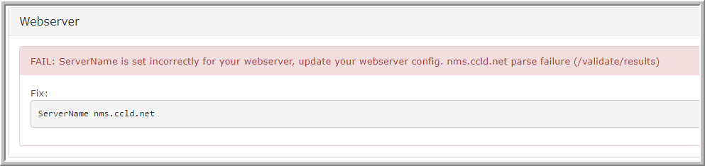

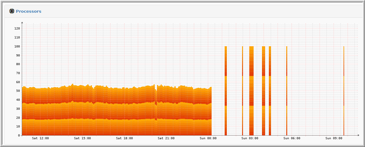

It appears that after the automatic update from yesterday evening that our LibreNMS instance is no longer working as it will not connect to the database based upon running the ./validate.php script. Data is no longer being written to the database, devices are not showing any data since 12:15 AM
Validate Results: (GUI)
Results of ./validate.php (Comamnd Line)
LibreNMS | 22.8.0-42-gc2761b4e1
DB Schema | 2022_07_03_1947_add_app_data (244)
PHP | 8.1.9
Python | 3.8.10
Database | MariaDB 10.5.15-MariaDB-1:10.5.15+maria~bionic
RRDTool | 1.7.2
SNMP | 5.8
[OK] Composer Version: 2.4.1
[OK]
[OK] MySQl and PHP time match

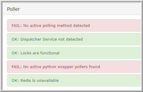

**[FAIL] No active polling method detected**
**[FAIL] No active python wrapper pollers found**

Not writing to database, not showing SNMP results in the GUI:
