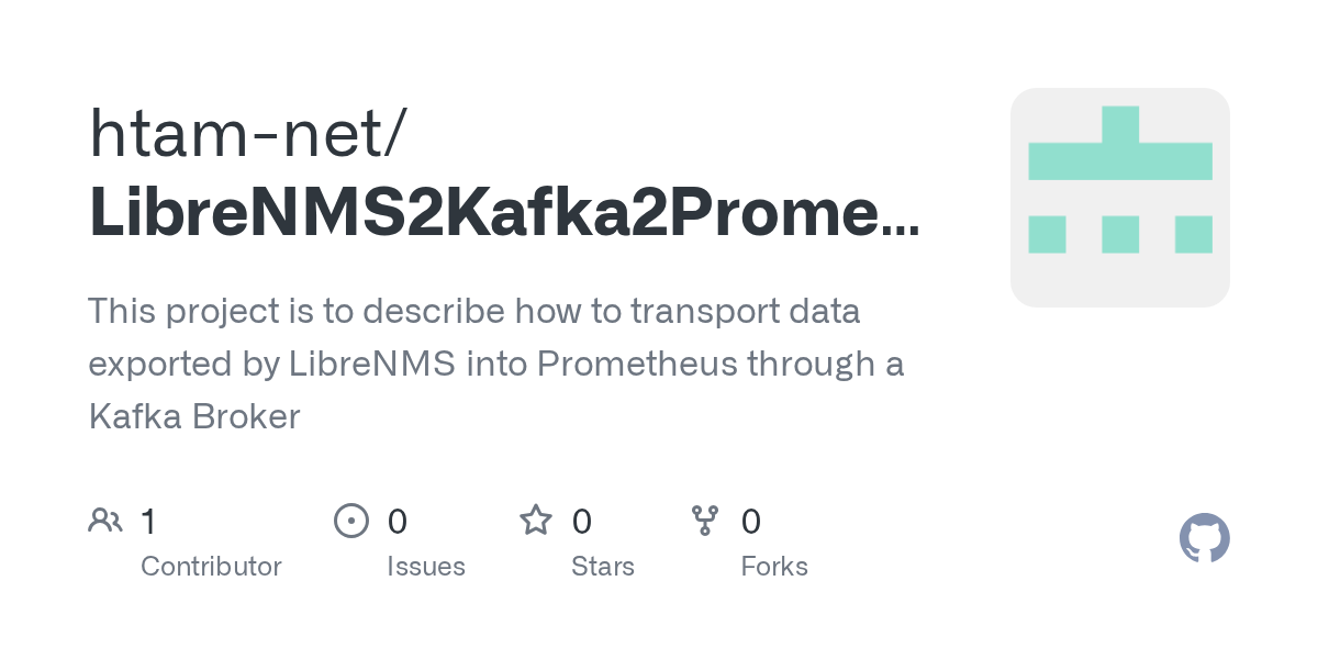

LibreNMS into Kafka into Prometheus
Hello to all,
Hope this is the right place. If you think it should be posted in an other topic, please let me know.
I would like to share my findings and experience with transporting LibreNMS exported-data with Kafka so that to funnel these data into Prometheus.
My use case is to gather local LibreNMS instances (for reasons) into a big Prometheus (+ grafana) central data gathering platform (and I can’t use distributed pollers … again reasons.
Any feedback is welcome.
This is really a first try. VRL language of Vector is a bit tricky to use.
I will try to post added content.
