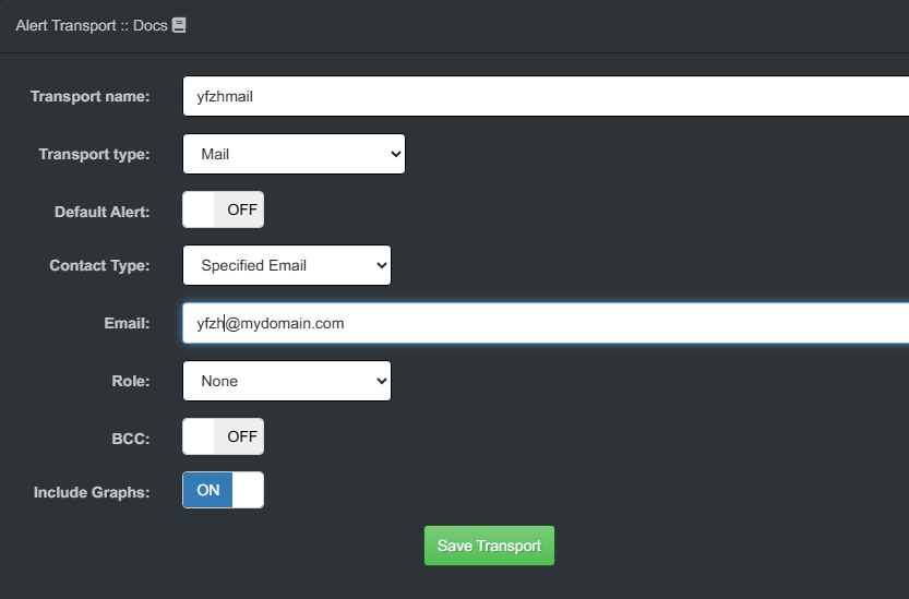

Hello, please see the attached screenshots.
Alert rule for testing.
Alert template, this is the default one which applies to the above alert
Alert transport
Active alert
We have another librenms installed locally which works fine for email. The rules and transport are copied from it.
Thank you.
