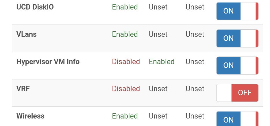

Yep, go to the device, click settings, then modules and look for vminfo.
Yeah, looks like it’s enabled under “Discovery Modules”?
(It’s “off” under “Poller Modules”.)
I don’t know if something has changed there recently. I’ve never looked at that page before
So should I turn that off and see if the SSH login attempts stop? Is there any reason I’d want to keep that enabled?
