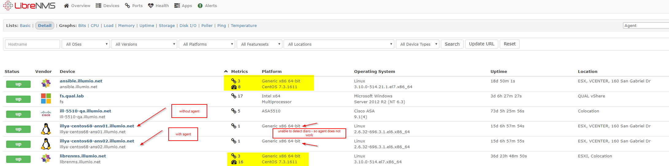

I need to monitor my CentOS 6.8 hosts with certain applications. Is there way to do it? What are the steps?

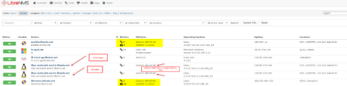

Thank you Murrant for your help. But I guess we came back to square one. I started conversation because documentation either is not complete or I am missing something. I setup an agent according to documentation, which is only few steps. As I mentioned in beggining - there is no systemd for CentOS 6. I did configure xinetd per instruction. I configured 2 of my lab VMs - one with agent and other without: I see no difference between data being presented to me in web interface for both VMs.

Also, the distro detection is done by the distro script. The setup of this is part of our overall install docs:
http://docs.librenms.org/Installation/Installation-CentOS-7-Nginx/#configure-snmpd
You don’t need the unix-agent / applications to get that working.
thank you gentlemen - started new lab VM from scratch and was able to make things work. thank you again.
