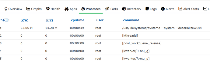

With the Unix-agent module, you already can do so.
See Check_MK Setup - LibreNMS Docs
Once up and running, you can see the processes:

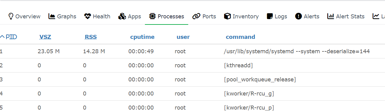

And with that, you can create alert rules (but inverted, as in; the process is not found)
Use the ‘process.command’ option in the rule:
And invert the match so it alerts when the process with that name is not found.
