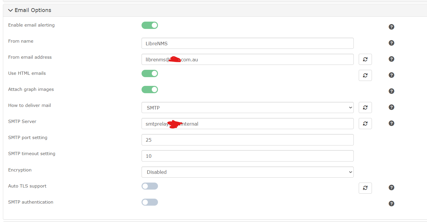

Hi All,
Also experiencing a very similar issue on a clean install of Debian 12. I press the test email button on the transport the first one comes through. then another click at about 30 seconds later no email even though the test mail sent successfully appears. I reboot a server it shows in the alerts but no email alert is sent. I am using the default rules and no custom ones all assigned to the transport.
Please could you advise? I haven’t found anything on the forums describing this behaviour. this is the first post I have seen with another Debian 12 instance having the same issue:
