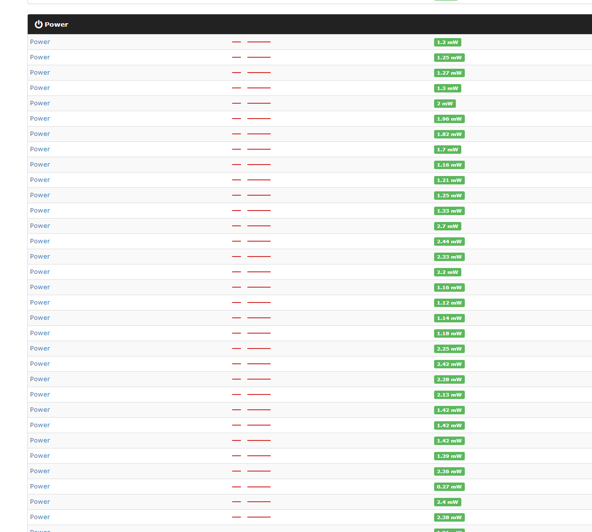

Mellanox 100Gbe SR4 Ethernet Optics light levels

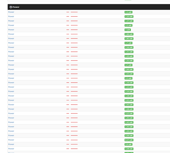

When I discover the device. It find all the optics and light levels. I can see the specifics for (optics, channel, etc) under the device “inventory”, but on the device “overview” it just lists all of the device as “Power” under the “Power” area. Is there anyway to display the optic port, direction (Tx or rx), and channel (1-4 in my case) under the Overview?

Hi @Richard_Angeletti
Probably. The discovery and polling of the sensors to be imported should be adapted to include the interface name, TX/RX, etc.
You need to figure out which OIDs are providing these details, and look at our documentation and other examples of devices to see how you could implement that.
