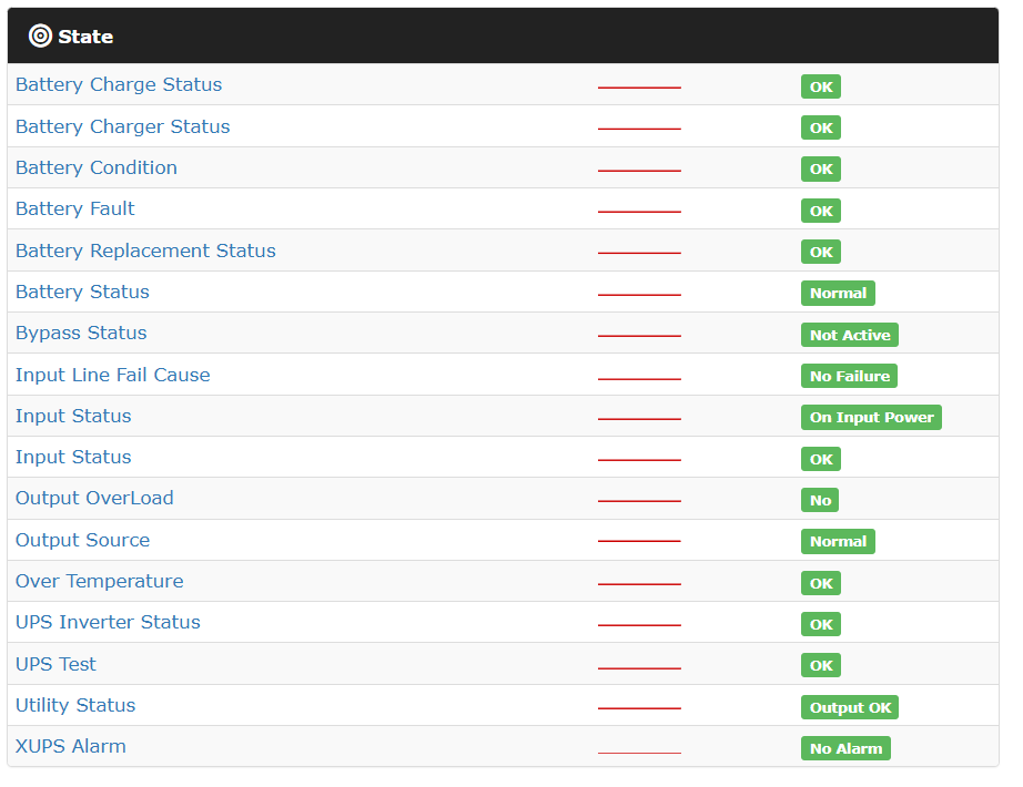

I have a large fleet of Eaton 9130 UPS’s that have the following “state” health sensors.

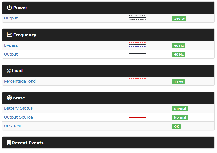

I have a a couple newer Eaton 9PX UPS’s that have fewer health sensors. This is causing the UPS health to be reported as good when in fact it isn’t. In this case I have a 9PX indicating that it’s battery check failed but due to the missing health sensors librenms is not able to alert me.

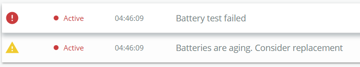

Here are the active alerts on the UPS itself.
Both models are using SNMPv1 and my librenms deployment is on the current branch updates.
I’m at a loss on how to resolve the missing sensors
