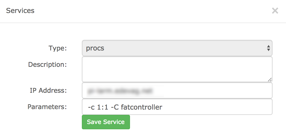

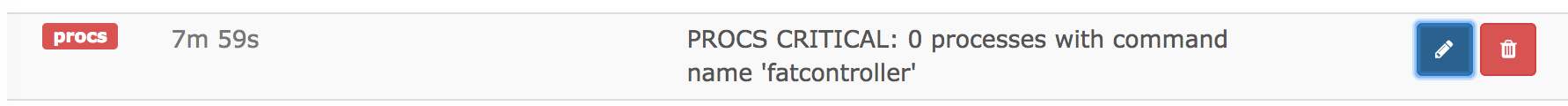

Monitor services (procs) with an agent (check_mk_agent)
I’ve added some services (procs) on the server where I run LibreNMS. It works great and I can use regular Nagios parameters (check_procs) to set thresholds and limits. I want to do this on all the servers that are monitored by LibreNMS, but when I add the same service on the different devices, I get “PROCS OK: 0 processes with command name XXX”. I use check_mk_agent on the servers that are monitored by LibreNMS. Do they also need Nagios check_procs? How do I configure the agent to use Nagios plugins?

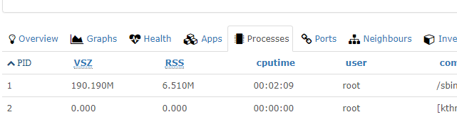

Thank you for the quick answer! I’ve already installed the check_mk-agent. I was able to check the cron-process correctly, but when I try to monitor something else (fatcontroller for example); it fails.
I’m not sure I have never played with that… are you able to to see the process tab for that device in librenms?
link to the to the agent code - librenms-agent/check_mk_agent at master · librenms/librenms-agent · GitHub
Yes, the process tab showed up when I installed the check_mk_agent.
@stefaned post the output of: ./check-services.php -d
Thanks! The check for bluetoothd seems to be done locally instead of on the remote device.
DEBUG!
SQL[e[0;33mSELECT * FROM devices AS D, services AS S WHERE S.device_id = D.device_id ORDER by D.device_id DESCe[0m]
Nagios Service - 37
Request: /usr/lib/nagios/plugins/check_procs -c 1:1 -C bluetoothd
Perf Data - None.
Perf Data - DS: procs, Value: 0, UOM:
Response: PROCS CRITICAL: 0 processes with command name ‘bluetoothd’
Service DS: {
“procs”: “”
RRD[e[0;32mupdate /opt/librenms/rrd/pi-hall.domain.net/services-37.rrd N:0e[0m]
Sending pi-hall_domain_net.services.services.37.procs 0 1508769128

Are Nagios-plugins for local host only? Is it possible to use the Nagios-plugins on a remote host (a “device”; i.e. a monitored server)? I need to check for certain processes and files on my different servers. I have the check_mk_agent installed and realised that I can build alarm rules for processes using that. But is it also possible to check for files (like “check_file_exists”-Nagios-plugin) on remote systems?
Thanks!
The nagios plugins are are only for the local host.
