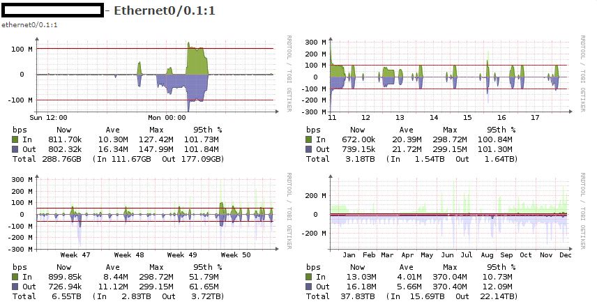

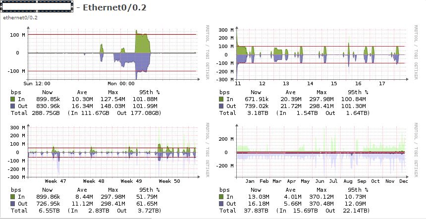

They are indeed reported but the trafic is not right, it is only reporting the trafic on the physical interface.
I add screenshots to my post to explain.

Eth0/0.2 sub interface
Eth0/0.1:1 sub interface
