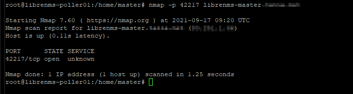

Hi Santosh,
Please see below nmap on port 42217 from my remote poller to the master (where rrdcached service is running).
As you can see, the port is open.
You need to find out why the port is closed in your case. This means your poller will not be able to connect to your master rrdcached instance since it does not see an open/listening port.

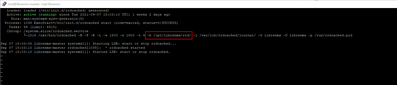

ok back to rrdcached
I noticed that the output of the rrdcached service status (you sent few days ago) points to /var/tmp:
root@dc5up-vlibrenms01:~# systemctl status rrdcached
● rrdcached.service - Data caching daemon for rrdtool
Loaded: loaded (/etc/systemd/system/rrdcached.service; enabled; vendor preset: enabled)
Active: active (running) since Thu 2021-09-09 09:49:24 UTC; 33s ago
Process: 29833 ExecStart=/usr/bin/rrdcached -w 1800 -z 1800 -f 3600 -s librenms -U librenms -G librenms -B -R -j /
Main PID: 29836 (rrdcached)
Tasks: 2 (limit: 4915)
CGroup: /system.slice/rrdcached.service
└─29836 /usr/bin/rrdcached -w 1800 -z 1800 -f 3600 -s librenms -U librenms -G librenms -B -R -j /var/tmp
Sep 09 09:49:24 dc5up-vlibrenms01 systemd[1]: Starting Data caching daemon for rrdtool…
Sep 09 09:49:24 dc5up-vlibrenms01 systemd[1]: Started Data caching daemon for rrdtool.
And it does nowhere points to /opt/librenms/rrd directory, and I think that’s why it keeps saying “Could not read RRD file”
See my service status below:

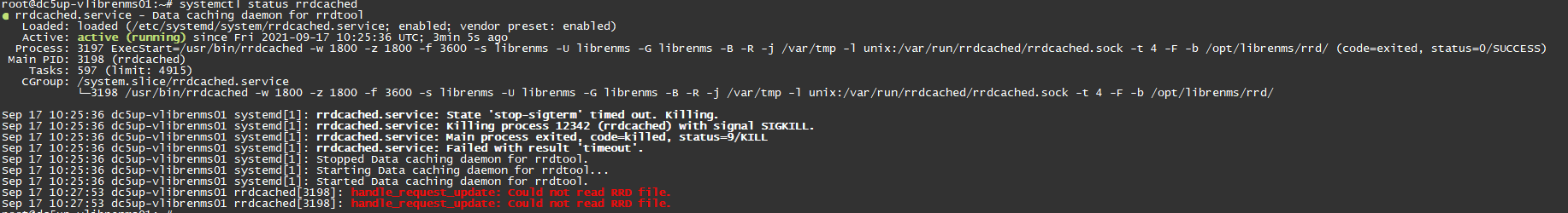

Hi @kalamchi75
I see that the number of errors seem to have reduced now. But I still get the error and the /var/tmp has not dissappeared but /opt/librenms/rrd has been added to the output.
I did a restart before taking this snippet.

Hi @kalamchi75
It’s back.
Active: active (running) since Fri 2021-09-17 10:25:36 UTC; 5min ago
Process: 3197 ExecStart=/usr/bin/rrdcached -w 1800 -z 1800 -f 3600 -s librenms -U librenms -G librenms -B -R -j /var/tmp -l unix:/var/run/rrdcached/rrdcached.sock -t 4 -F -b /opt/librenms/rrd/ (code=exited, status=0/SUCCESS)
Main PID: 3198 (rrdcached)
Tasks: 614 (limit: 4915)
└─3198 /usr/bin/rrdcached -w 1800 -z 1800 -f 3600 -s librenms -U librenms -G librenms -B -R -j /var/tmp -l unix:/var/run/rrdcached/rrdcached.sock -t 4 -F -b /opt/librenms/rrd/
Sep 17 10:29:58 dc5up-vlibrenms01 rrdcached[3198]: handle_request_update: Could not read RRD file.
Sep 17 10:30:00 dc5up-vlibrenms01 rrdcached[3198]: handle_request_update: Could not read RRD file.
Sep 17 10:30:03 dc5up-vlibrenms01 rrdcached[3198]: handle_request_update: Could not read RRD file.
Sep 17 10:30:08 dc5up-vlibrenms01 rrdcached[3198]: handle_request_update: Could not read RRD file.
Sep 17 10:30:10 dc5up-vlibrenms01 rrdcached[3198]: handle_request_update: Could not read RRD file.
