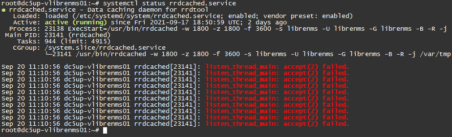

I continue to see these errors when I check the status.
The other thing is I am not able to get rrdcached to start talking on the 42217 port. I have tried to configure it as (hostname/ip):42217 in the config but that doesn’t help. Moreover it breaks by graphs with the error message that it is not able to connect to rrdcached. :frowning:
I don’t know how to go further from here. I double-checked the config output but now I see that /opt/librenms/rrd is mentioned. As for /var/tmp… I still don’t know why that is coming up and I have not changed anything to make it come up that way. I tried an install on my raspberrypi device and it comes up as the same.

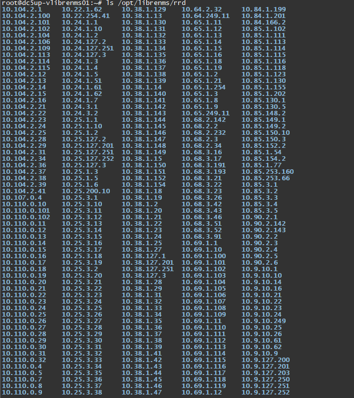

We are sure your rrd files are in /opt/librenms/rrd ?

We are sure your rrd files are in /opt/librenms/rrd? - Yes Sir.

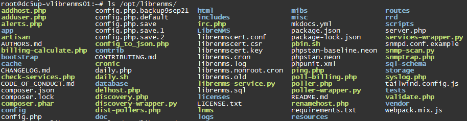

Where can I find this database folder containing the rrdtool folder? I tried to look into my database folder and I don’t see it in there.
root@dc5up-vlibrenms01:~# ls /opt/librenms/database/
factories migrations schema seeders seeds

I tried the option of changing the ownership of /var/tmp to librenms but that seems to have induced another error:
root@dc5up-vlibrenms01:~# systemctl status rrdcached
● rrdcached.service - Data caching daemon for rrdtool
Loaded: loaded (/etc/systemd/system/rrdcached.service; enabled; vendor preset: enabled)
Active: active (running) since Mon 2021-09-20 13:28:59 UTC; 51s ago
Process: 22040 ExecStart=/usr/bin/rrdcached -w 1800 -z 1800 -f 3600 -s librenms -U librenms -G librenms -B -R -j
Main PID: 22047 (rrdcached)
Tasks: 337 (limit: 4915)
CGroup: /system.slice/rrdcached.service
└─22047 /usr/bin/rrdcached -w 1800 -z 1800 -f 3600 -s librenms -U librenms -G librenms -B -R -j /var/tmp
Sep 20 13:28:59 dc5up-vlibrenms01 systemd[1]: Starting Data caching daemon for rrdtool…
Sep 20 13:28:59 dc5up-vlibrenms01 systemd[1]: rrdcached.service: Failed to parse PID from file /run/rrdcached.pid:
Sep 20 13:28:59 dc5up-vlibrenms01 systemd[1]: Started Data caching daemon for rrdtool.
Sep 20 13:29:40 dc5up-vlibrenms01 rrdcached[22047]: handle_request_update: Could not read RRD file.
So I rolled back changes and hit a service restart.

Hi Santosh,
In my case, the rrd files are all under /opt/librenms/rrd directory.
Do you have the same directory structure ?
please find where your rrd files are located.
Hi @kalamchi75
Yes. I have the same directory structure:
