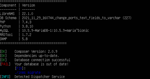

I’m trying to update my libreNMS server. the daily.sh has ran without any issues. However the validate gives the following error:
When i try to rune the ./lmns mirgrate i get the following issues:
