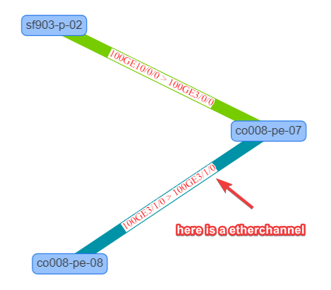

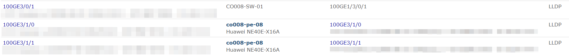

Hi! Im having issues to view multiple links by xDP (port-channel, LAG,etc) i only see one link between devices. I have disable de ARP discovery.
Also can´t see on network map LLDP neigbhobrs links if only one device is on the databese(need to discovery both) . I tried to use the old map and it works correctly “$config[‘gui’][‘network-map’][‘style’] = ‘old’;”
Could be something wrong with this lines at /opt/librenms/html/includes/print-map.inc.php? I tried to play with "$config[‘network_map_vis_options’] = " but nothing happens.
" // Ensure only one link exists between any two ports, or any two devices. it prints only one link
if (!array_key_exists($link_id1, $link_assoc_seen) &&
!array_key_exists($link_id2, $link_assoc_seen) &&
!array_key_exists($device_id1, $device_assoc_seen) &&
!array_key_exists($device_id2, $device_assoc_seen)) {
$local_port = cleanPort($local_port);
$remote_port = cleanPort($remote_port);
// $local_port = cleanPort($items[‘local_port_id’]);
//$remote_port = cleanPort($items[‘remote_port_id’]);
$links = array_merge(
array(
‘from’=>$items[‘local_device_id’],
the LLDP neighbors from co008-pe-07
what the map shows
