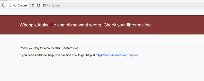

I am new to librenms, I tried installing the application on Ubuntu 20.04 and 22.04, after some troubleshooting I am able to successfully validate as shown below, but when I access GUI, I see Pre Install checks all green, configure database all green, but when I click on user, i get error. I looked at the logs and find below. Any thoughts? Thank you.

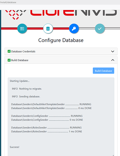

Successful DB:
New User Creation Page Error:
LOG FILE ERROR:
[2025-03-27T06:06:07][ERROR] SQLSTATE[42S22]: Column not found: 1054 Unknown column ‘is’ in ‘where clause’ (Connection: setup, SQL: select * from users where is = admin limit 1) {“exception”:“[object] (Illuminate\Database\QueryException(code: 42S22): SQLSTATE[42S22]: Column not found: 1054 Unknown column ‘is’ in ‘where clause’ (Connection: setup, SQL: select * from users where is = admin limit 1) at /opt/librenms/vendor/laravel/framework/src/Illuminate/Database/Connection.php:829)
[previous exception] [object] (PDOException(code: 42S22): SQLSTATE[42S22]: Column not found: 1054 Unknown column ‘is’ in ‘where clause’ at /opt/librenms/vendor/laravel/framework/src/Illuminate/Database/Connection.php:423)”}

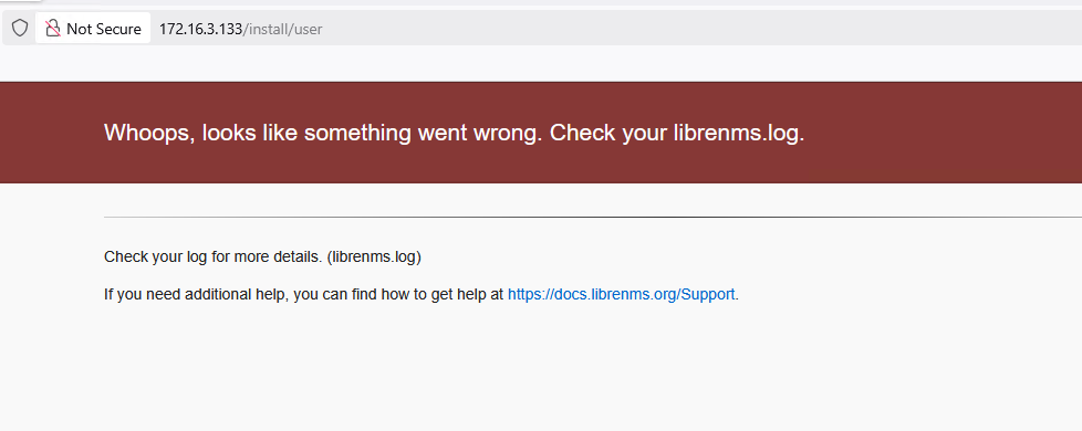

I am getting the exact same error on Rocky Linux.
I’m stuck in the same boat. Running Ubuntu 24.04.2 LTS.

I have the same issue. I believe the installer is busted somewhere. Hopefully a fix is coming.
  1. At first, there was an error at the end of “Build Database”. I re-installed and tried to edit the .env file first, and the “Build Database” completed successfully.
  2. But when I go to “Create Admin User”, I get the same error as you.
These should be fixed upstream. Easiest way to fix it is to start fresh. If you want to try to recover your install, just git pull
