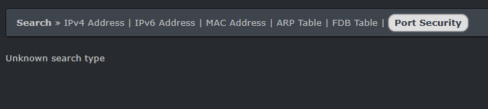

Hello, I am trying to test the new polling module but I am getting “Unknown search type”
instead of going through global search. can you try from overview→Portsecurity ?

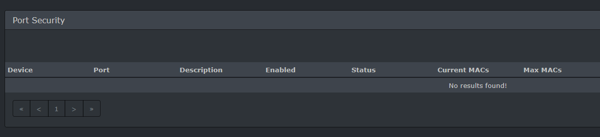

Yes, it is empty. The second screenshot is from overview.
is the module enabled in global settings ?
also at device or OS level

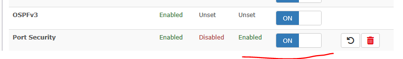

The poller module is enabled and in device settings it is also enabled (inherited from global settings)
ahh, silly question but only other thing i suspect, is port-security enabled in device ports configuration?
Not silly but yes i have it configured :smiley: I’ll do some more testing… I was just wondering if I am missing some configurations from librenms side.

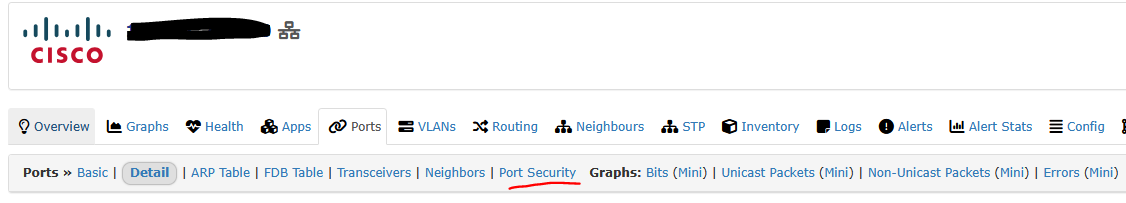

is portsecurity option showing under device→ports
if its not showing, then inheritance from global settings is not working
override module settings on 1 device and check
at least in my case , this was the issue

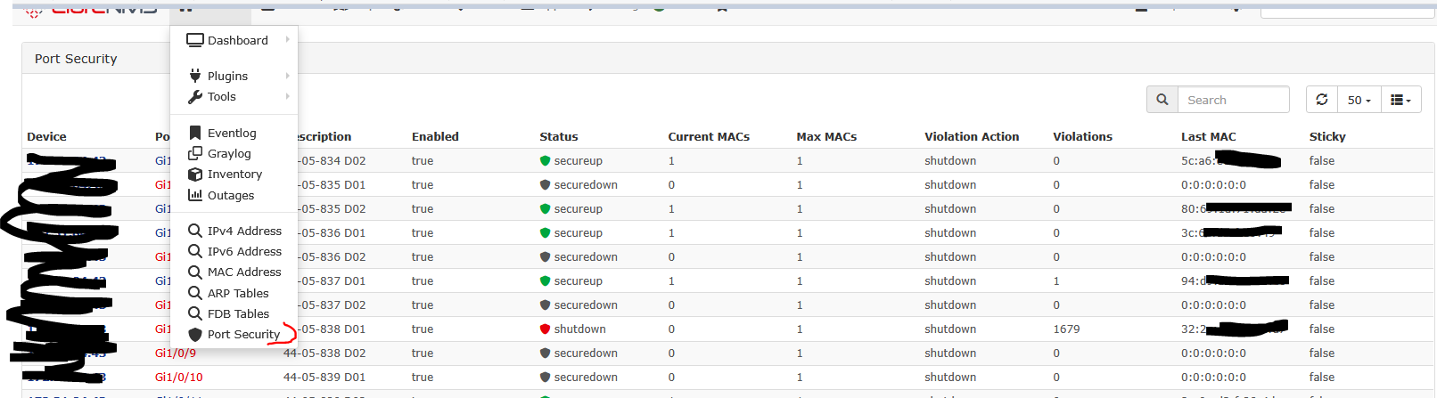

The link you are using got moved to Ports → Port Security. I’ve just fixed that legacy link not being removed.
I had to enable this on a device level. So the global configuration is not inherited?

but for some reason, global setting not inheriting to devices
to make to work,executed below commands for ios and ios xe
lnms config:set os.ios.poller_modules.port-security true
lnms config:set os.iosxe.poller_modules.port-security true
