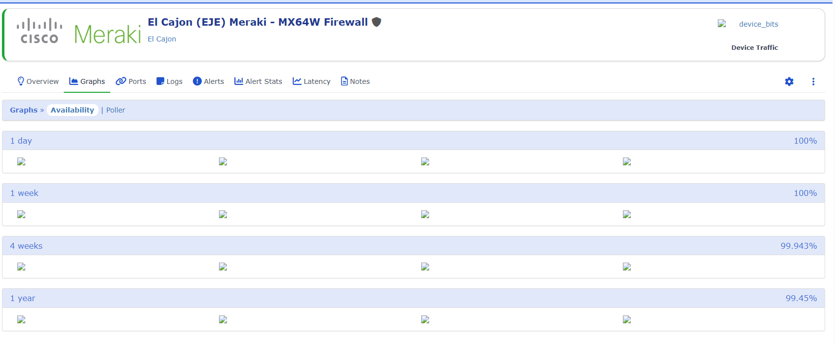

No Graphs are showing
None of the standard graphs are showing anymore. For any device. It has been like this for a week or so. I am on the daily updates. No errors in ./validate.php. Screenshot below. It also appears that the font recently increased too at the same time

Hi Jarrod,
Having the same issue, by any chance do you see something like this on your librenms,log file
[2026-08-06T10:57:50][CRITICAL] Exception: Error Failed opening required ‘/opt/librenms/includes/html/graphs//auth.inc.php’ (include_path=‘.:/usr/share/php’) @ /opt/librenms/LibreNMS/Util/Graph.php:186

Yes I do same message and error. Same error message when clicking on any graph.
Thanks for the error message, it looks like graph type is missing.
Can you give me the url for the graph image? (you can exclude base domain)

Here are a few of the links. All graphs have the same issue
/graphs?type=device_temperature&from=-1d&device=14
/graphs?type=sensor_temperature&from=-1d&id=487
/graphs?type=device_processor&from=-6h&legend=no&device=27
/graphs/device=302/type=device_availability/duration=86400/from=1786028400/
/graphs/to=1786114800/type=device_processor/from=1786028400/legend=no/device=302/

Weird stuff, I wonder why. Not many reports of this, so it must be a low chance to be affected.
Any chance you could walk back git revisions to see which one caused it?
I found an issue when the device doesn’t exist it was supposed to show a graphic with a not found message instead of a broken image link. Maybe that was your issue?
