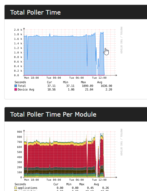

I then upgraded to 24.04 which also went well but at the end it was a little more of a fight as php was upgraded to 8.3. I’ve got everything running now and the poller seems to be running as expected however after the switch to 24.04/php8.3 I am not seeing any new data in any graph including the poller performance graphs. I am using rrd files and no rrdcache, all historical data is visible. I do not know where to start looking to resolve this issue. I’ve attached a snapshot of the poller graphs and the first gap is from the 20->22 upgrade with the gap at the end being after the upgrade from 22-24.

So… oddly enough, I come in this morning and it appears to be working. It started working around 2100hr last evening. I’m thinking this may have had something to do with an issue that occured after updating to php8.3 were I was receiving a timezone mismatched which ended with the time by php being around 2100hrs before correcting it.
Very strange.
It’s exactly that, if the timezone went back then it will have discarded new data thinking it had already been written
Then that explains it. I’m not sure how during the upgrade the timezone config went south but everything seems to align today with the expected traffic patterns that we experience.
