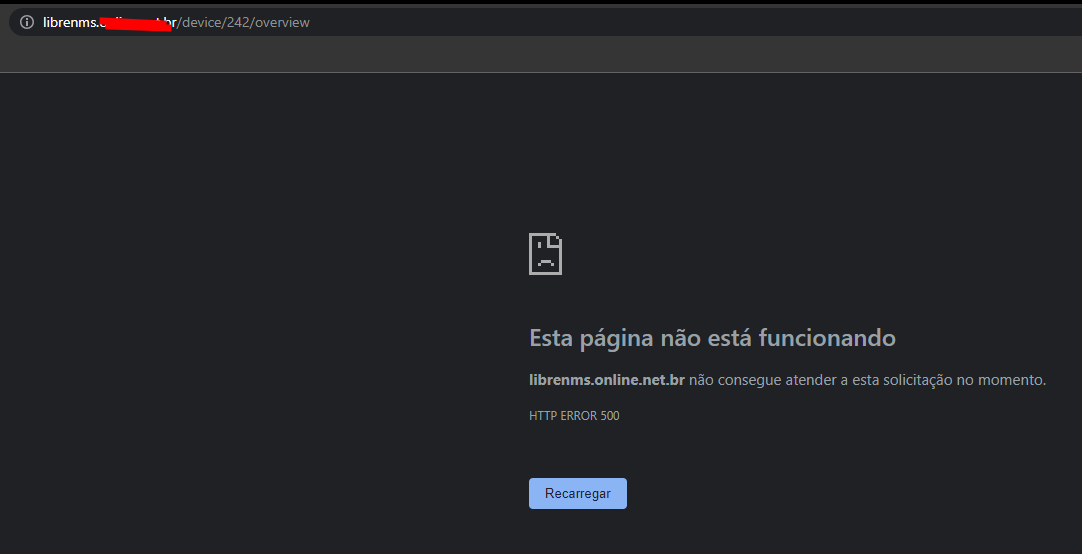

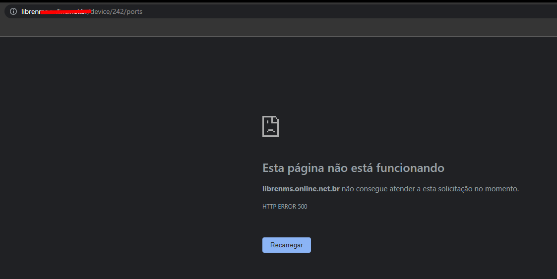

Overview and ports HTTP ERROR 500
Hey,

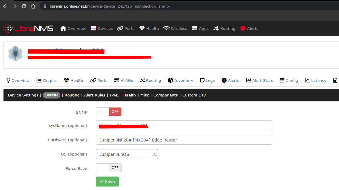

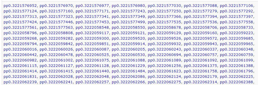

I added a Juniper router that I use as a PPPoE server, I forgot to adjust the Interface Poller to ignore pppoe and LibreNMS made the discoveries of many interfaces, with that I cannot access the Overview and Ports tab, even deactivating SNMP and using the script purge-port.php, I also can’t remove it to add it again.

I noticed that LIbreNMS is still discovering pppoe. How do I ignore?

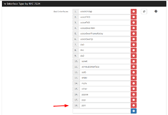

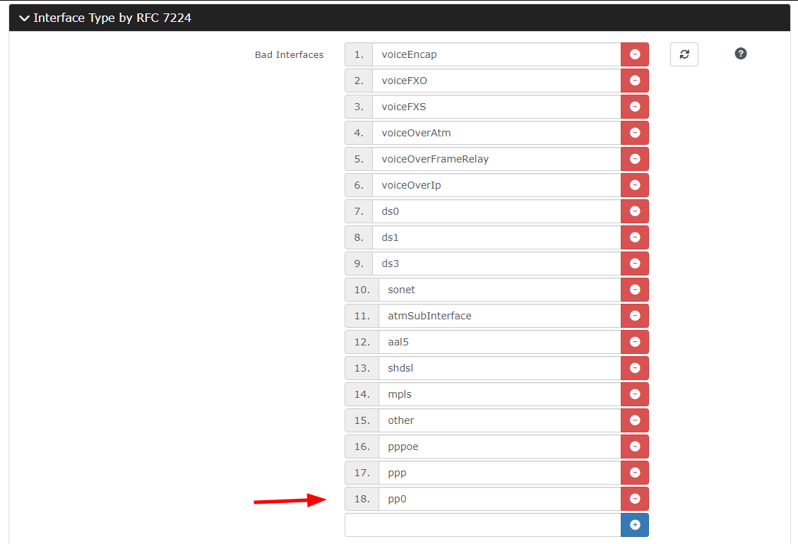

Now I put pp0 in Bad Interfaces, is this setting correct?
I managed to solve it, I ignored the interfaces pp0.
lnms config:set bad_if_regexp.+ '/^pp0.*/'
