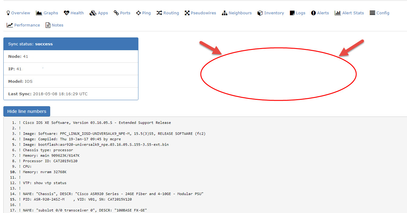

I have got oxidized working on Librenms on Ubuntu 16.04 LTS.
I however am having issues with the Config Version not appearing under ‘Config’ and cant find why either-would appreciate any assistance you can give.

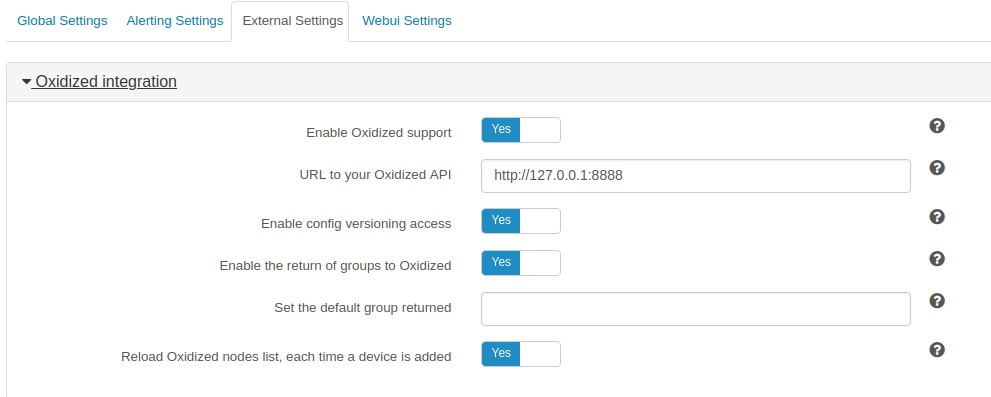

and make sure in settings → external → oxidized that version access is set to yes.
That might be why the drop down menu is not appearing.

Thanks Chas, the enable config versioning access was already enabled and I restarted oxidized several times when I noticed it wasnt appearing-still no luck.
