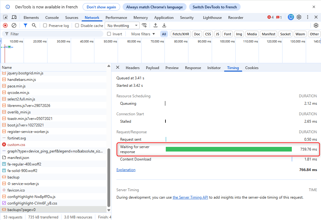

I’m using the latest version of Oxidized (v0.37) and the latest version of LibreNMS (26.8.0-dev.47+ef1d2dd83 - Wed Jul 29 2026 22:23:52 GMT+0200). My OS is also up to date.
I’ve noticed that this problem only appears on Fortinet (FortiGate) configuration backups. I don’t experience this slowness on Cisco servers.
Also, the line numbers seem to be displayed strangely. Is this related ? Once it goes past 9999, the counter seems to restart at 1000.
On Cisco backups
On Fortinet backups :
My configuration has over 25,000 lines with Notepad
Thank you !
it looks like the 10000 is clipped on the right. I’ve sent a PR to fix the width and disable the features on large backups because it will lock up your browser.
