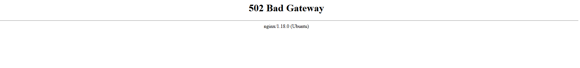

Same issue here. Getting NGINX 502 Bad Gateway on many LibreNMS URLs. What is the fix?

Hi all,
This morning my LibreNMS is showing 502 Bad Gateway on many URLs:
https://librenms.xxx/ OK
https://librenms.xxx/bills 502
https://librenms.xxx/bill/bill_id=31/ OK
https://librenms.xxx/bill/bill_id=31/view=history/ 502
etc.
And there are now errors on validate.php. Any ideas on this one?

I’m also getting the same as @steverpalmer - a 502 Bad Gateway error on the alert rules page after adding a new rule.
I’ve tried adding APP_ENV=production to .env but still get the same issues.
Looking at the nginx log on the server gives:
2025/06/09 15:46:47 [error] 1031#1031: *240057 FastCGI sent in stderr:

There was a change to stop hiding errors inside LibreNMS (old holdover from pre-fork).
This should not have caused any issues. But, some pages in the webui have too many errors which causes an error between nginx and php-fpm (headers too large). Especially errors in loops… Please list them here and we can get them cleaned up.
Except for the 502 errors from headers too large, all of these new error messages are non-fatal and should not have any affect on the operation of LibreNMS.
In summary:
  1. these errors existed before, but now they are visible
  2. they are non-fatal and will not cause any issues themselves
  3. some pages had too many errors causing an issue with php-fpm an nginx because the headers grew too large
  4. The errors are mostly easy to cleanup and we will work through them as we see them
