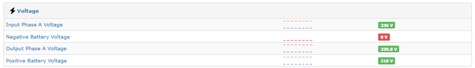

is there a missing sensor for the + / - battery voltages?
they are reading as 0.
could you verify the voltages and amperages are correct.

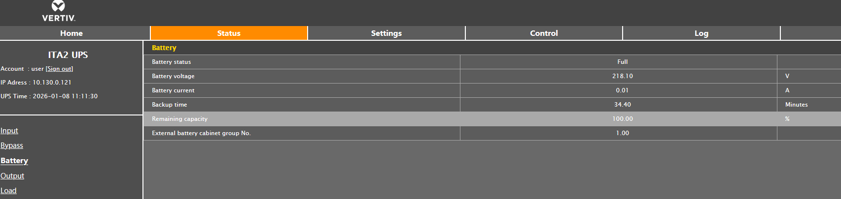

Hi @deagle746 ,
When I login to UPS I couldn’t find any + / - battery voltage reading.
The input/output Voltage, Current and Frequency reading is correct.
Fixed the OID for positive battery voltage , negative is still 0.
Is it valuable information? or skip if zero?

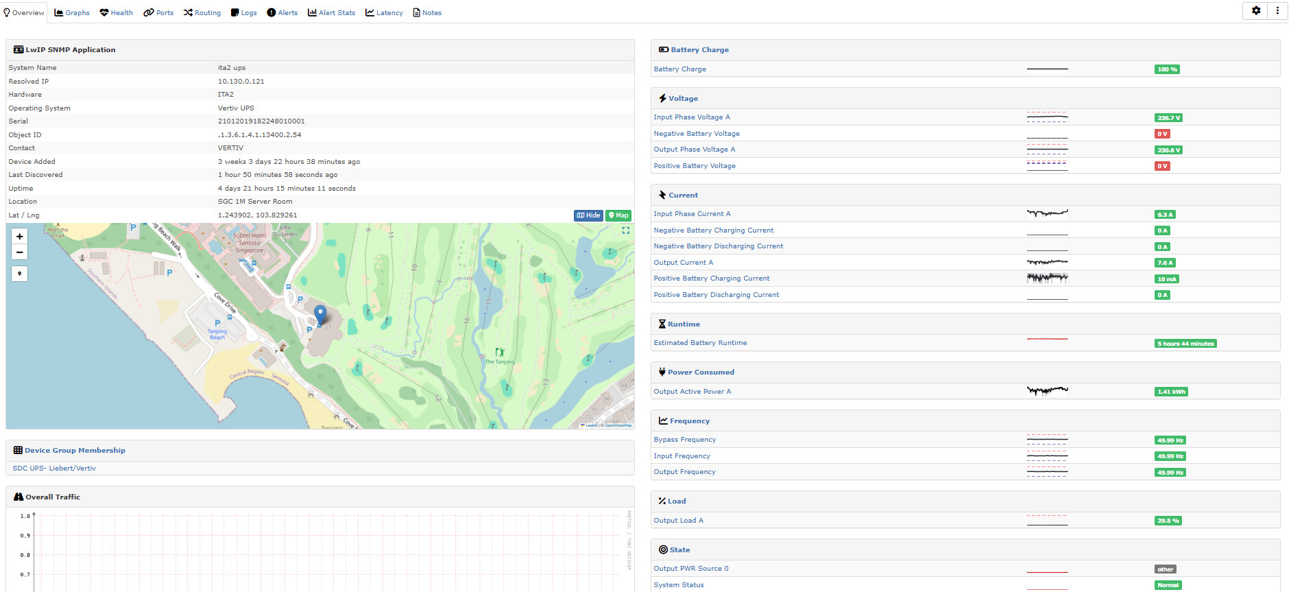

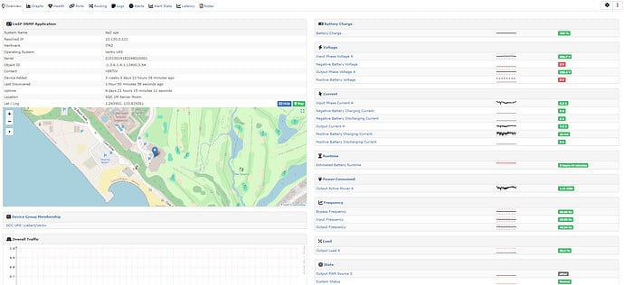

Remove and apply the patch. then rediscovery device.
Hi @deagle746 ,
Confirmed Positive Battery Voltage reading is correct.
Changed negative battery voltage to ignore if its a 0.
everything else looks good?
Hi @deagle746 ,
Yap, all look good.
