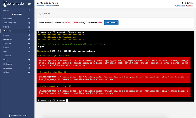

librenms:/opt/librenms$ ./lnms migrate
* Application In Production! *
Do you really wish to run this command? (yes/no) [no]:
> yes
Migrating: 2021_07_28_102443_plugins_add_version_and_settings
Migrated: 2021_07_28_102443_plugins_add_version_and_settings (17.29ms)
Migrating: 2021_08_04_102914_add_syslog_indexes
In Connection.php line 703:
SQLSTATE[HY000]: General error: 1799 Creating index 'syslog_device_id_program_index' required more than 'innodb_online_alter_log_max_size' bytes of modification lo
g. Please try again (SQL: alter table `syslog` add index `syslog_device_id_program_index`(`device_id`, `program`))
In Exception.php line 18:
g. Please try again
In PDOStatement.php line 117:
g. Please try again
