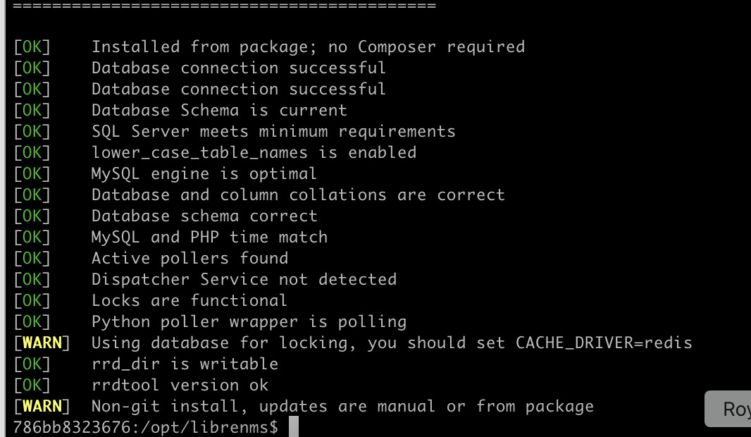

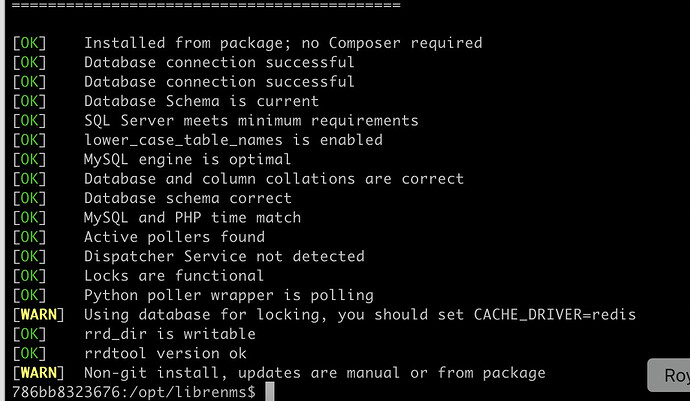

Validate.php after manually run poller:
d7959506a3b1:/opt/librenms$ /opt/librenms/validate.php
LibreNMS 25.2.0 (2025-02-23T13:02:21+00:00)
DB Schema 2021_02_09_122930_migrate_to_utf8mb4 (315)
PHP 8.3.17
Python 3.12.9
Database MariaDB 10.5.28-MariaDB-ubu2004
RRDTool 1.9.0
SNMP 5.9.4
[OK] Installed from package; no Composer required
[WARN] Using database for locking, you should set CACHE_DRIVER=redis
[WARN] Non-git install, updates are manual or from package

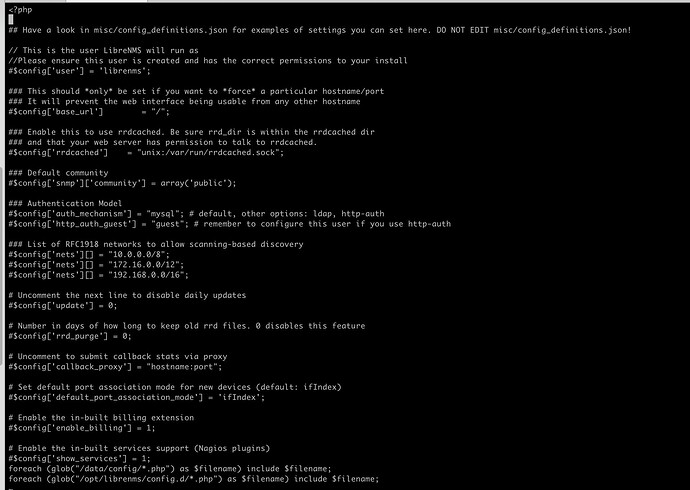

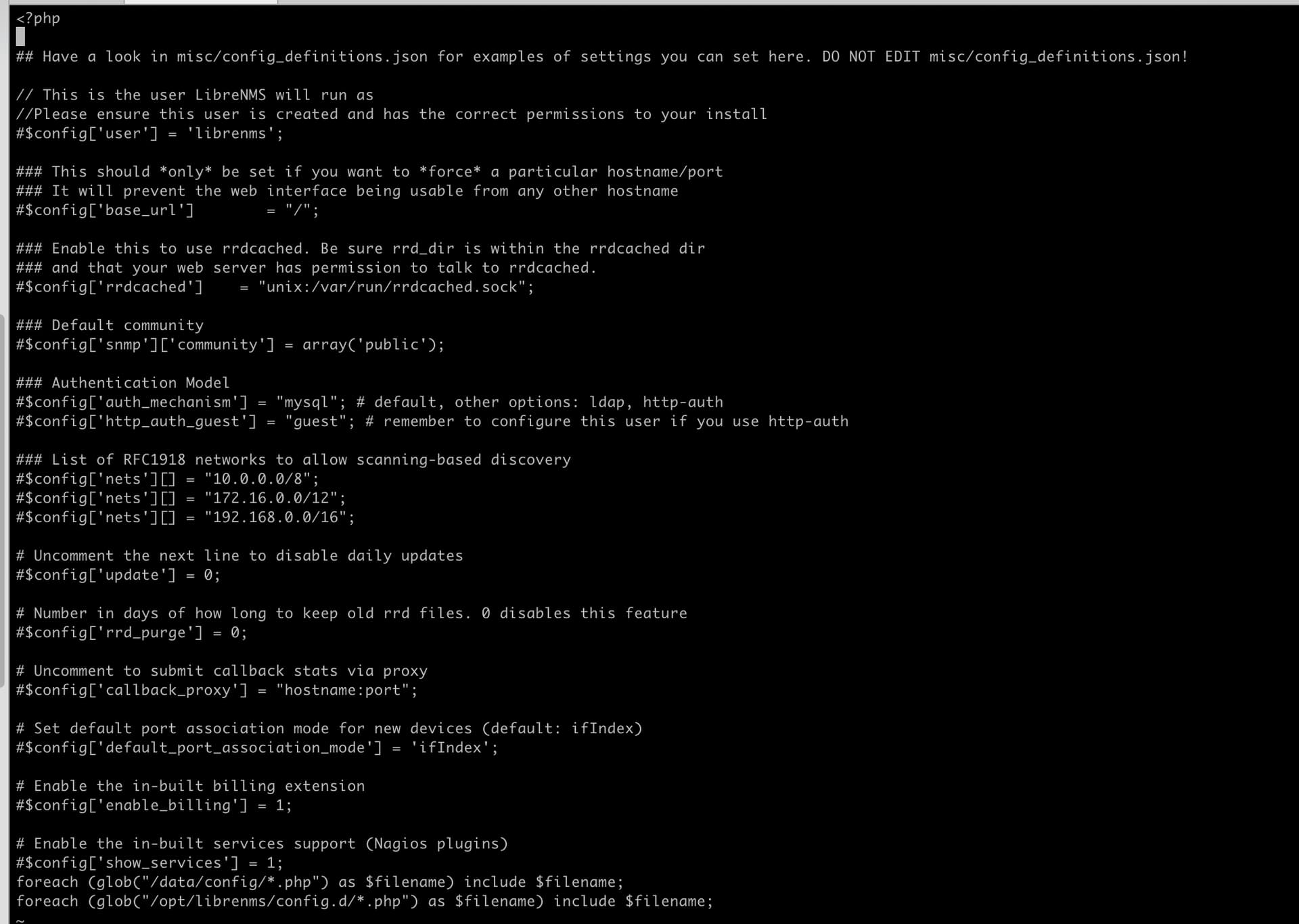

Strange situation is also my config.php, this file have only foreach and everything is hashed.

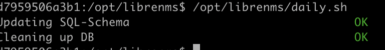

On daily.sh i have only this:
